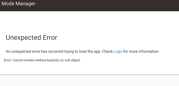

Following up[date to 2.3.4.127 the Mode Manager threw an error, log attached.
Tried removing and re-installing App but app showes erroe on loading.
Assistance needed please

Reverting to 2.3.4.123 made Mode Manager accessible again.

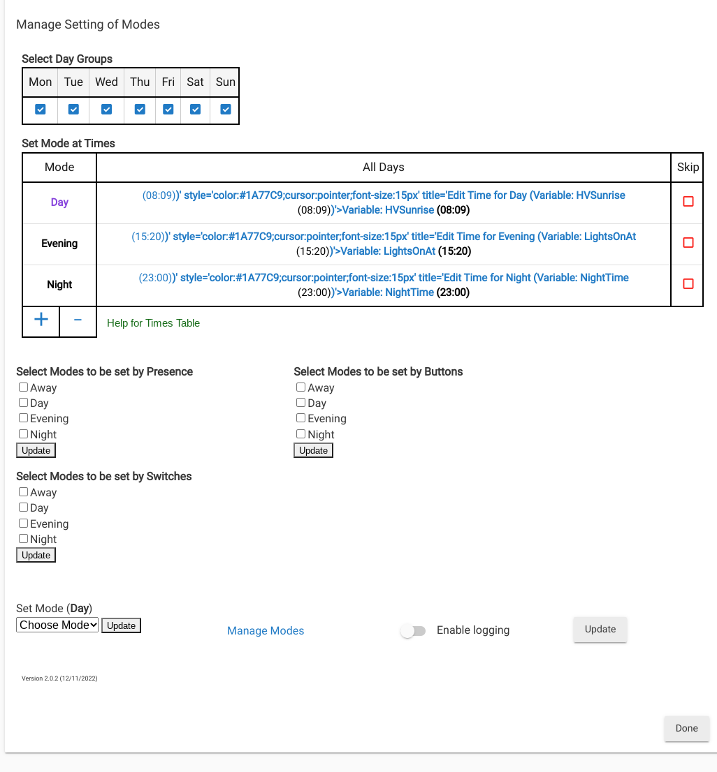

Mode manager setup attached.
Possible issue is that the update occurred around the time a Mode change to Evening was scheduled.
Hope this helps with a solution.
Weird. But I can see the problem. Fix will be in the next release.
Good Man. Thank you.

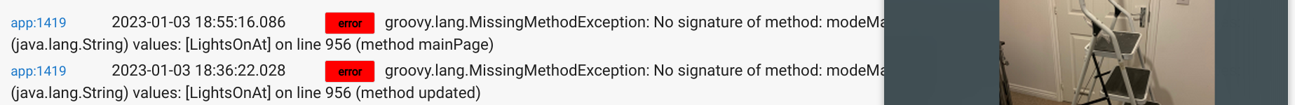

Afraid to say that the latest release 2.3.4.128 has not fixed my issue.
I will fall back to previous working version.
Afraid to say that the latest release 2.3.4.129 has not fixed my issue.
I will fall back to previous working version.(2.3.4.123)

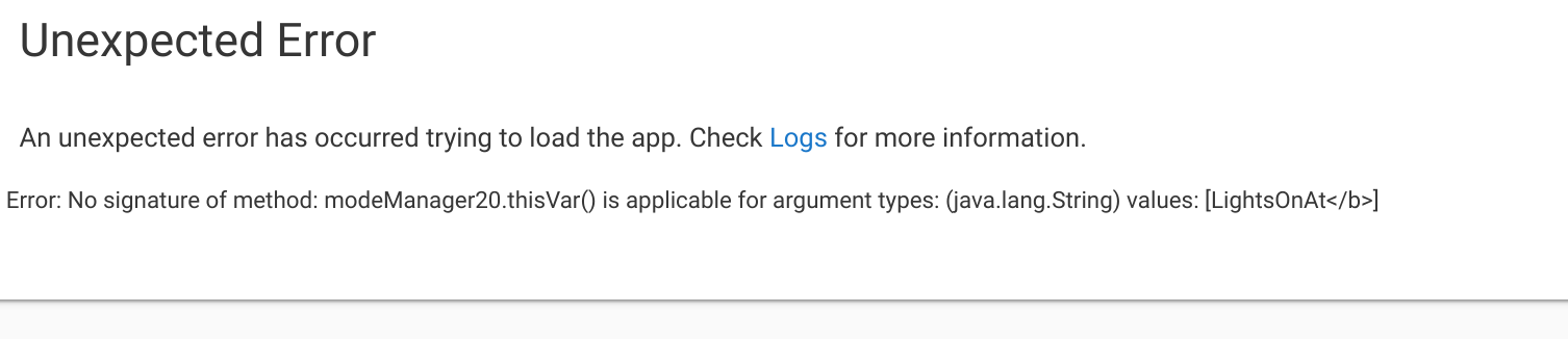

Please review this thread. Happy to provide additional information if requested.
Yeah, I see the problem with that. Variable times have a newly introduced bug. Fix in next release.
2.3.4.130 sorted it. Thanks
