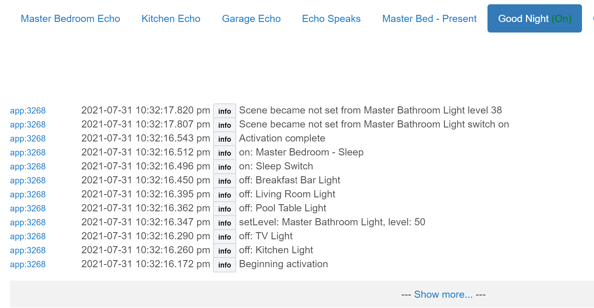

I have a virtual switch called sleep switch, it gets set to on when we tell alexa goodnight (scene), it gets turned off in the am when we tell alexa good morning (scene)

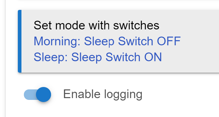

Mode Manager is setup to switch to sleep mode when the sleep switch is turned on, yet it seldom does

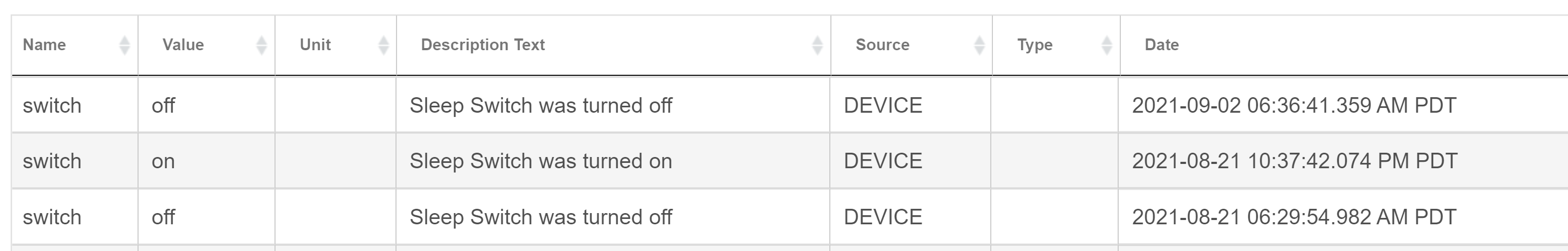

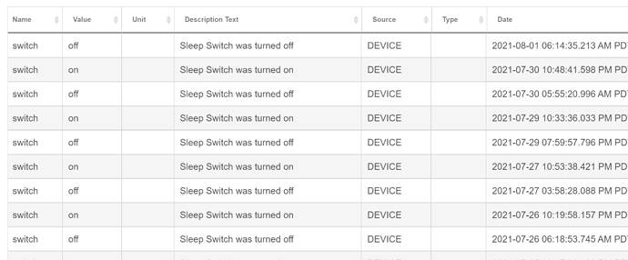

Here is the sleep switch, working fine

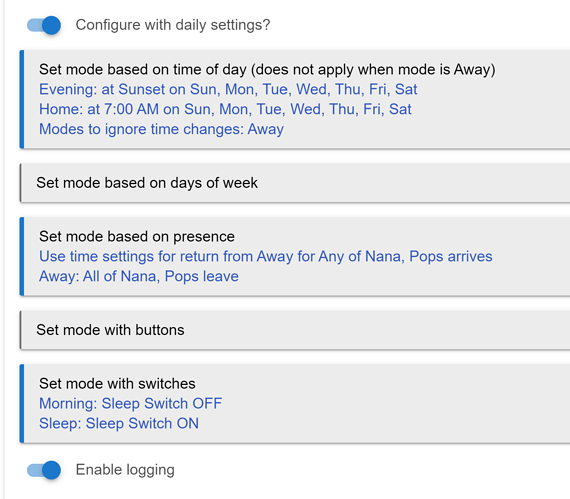

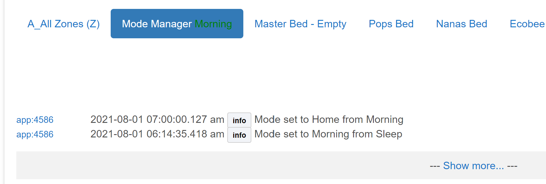

Here is mode manager

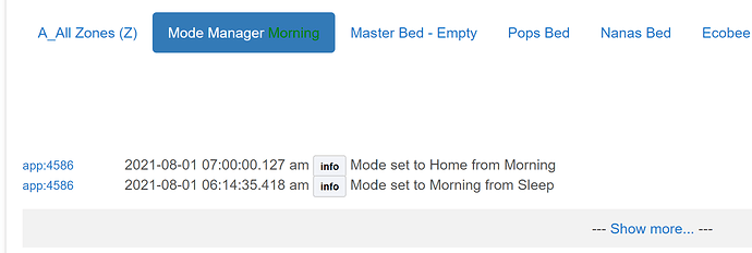

Not much in the log

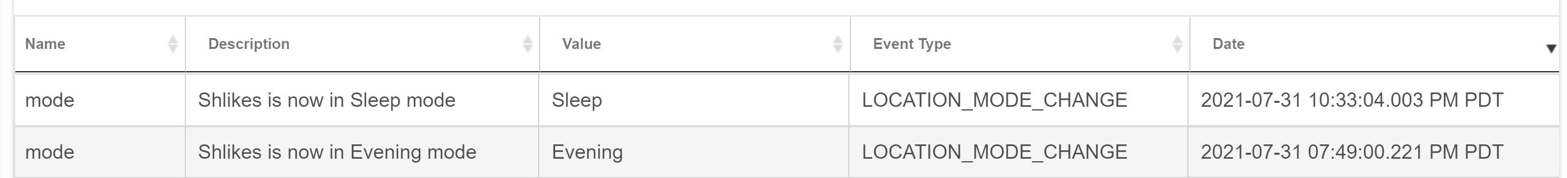

Look at the System Events log (left hand menu). It shows all of the mode changes. Since you're using a switch, you can just test it, see what happens (if anything) in that log (have to refresh the page, not a dynamic page). It appears that it WAS in Sleep mode based on the logs you showed, but System Events is the best way to see for sure.
Thanks Bruce, I'll keep looking
It was in-fact in sleep mode as I manually put it there after telling alexa goodnight. I open the browser, go to settings and mode, then update it to sleep, something I didn't have to do until recently

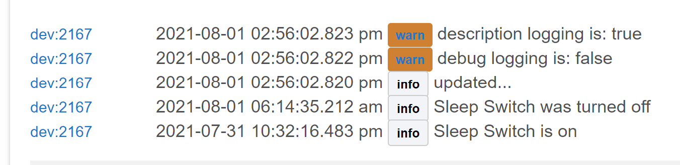

Good night via alexa at approx 10:32:16, sleep switch set to on
Sleep mode didn't trigger so I did it via the browser 45 seconds later

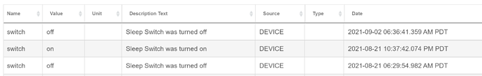

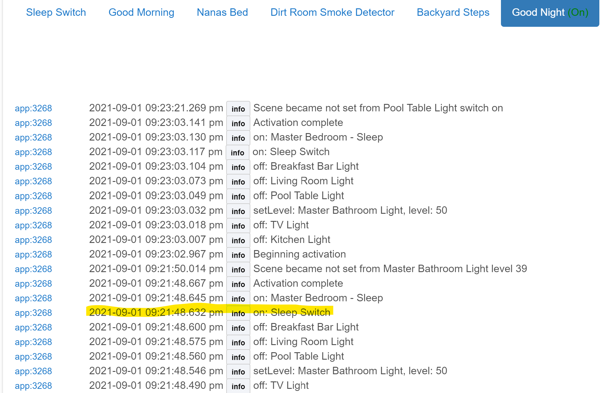

Here is an example of the sleep switch being turned on by the Good Night scene which is activated via Alexa

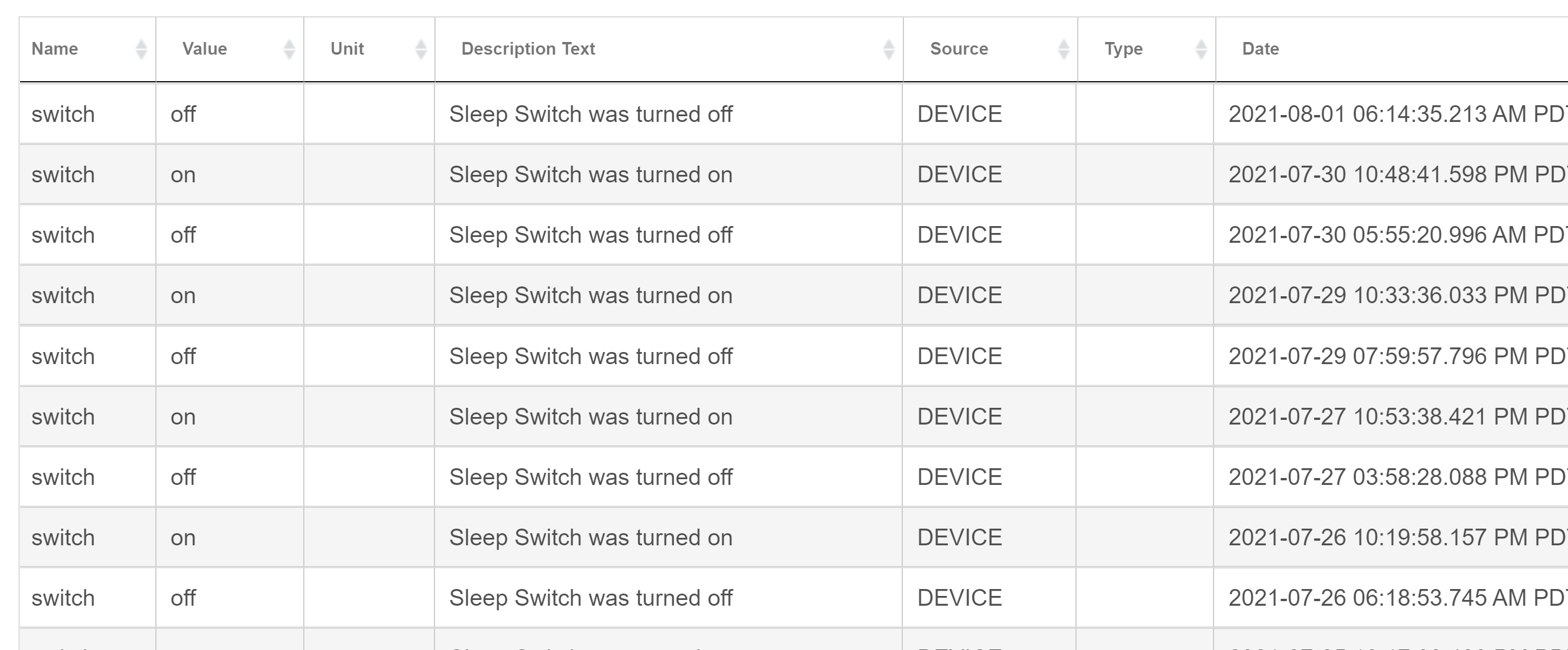

However the Sleep Switch event log has not been recording events since 8/21
The sleep switch is used by Mode Manager as noted before
Every morning, the sleep switch is set to off via a scene triggered via Alexa, it was never turned on or off after 8/21 until today. Good night and Good morning are used every day, w/o fail. It's how the alarm is set, mode changes and lights are turned on/off. no way we missed using it for over a week
So in short, the scene(s) ran, turned on/off the sleep switch, the sleep switch change was not recorded so mode manager didn't update the mode...

I use 2 HE scenes, one for good morning and 1 for good night that turns the sleep switch on/off. The issue was the Good Morning Scene was restricted to sleep and morning modes so if activated while in home mode, it did nothing
So long story short, I was me.... again
