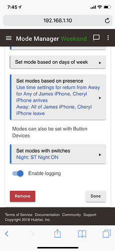

So I’m trying to setup mode manager correctly. In ST I had a WebCoRE piston that was pretty complex but it worked. I’m loving Mode Manager in HE - so much easier to configure! And when presence sensors stayed home on the weekend modes changed flawlessly. With just the one exception. It’s now Monday, when one of my presence sensors returns home, mode manager is changing to weekend. My configuration is as follows:
Can anyone see why Modr Manager would show the friend for today as weekend?

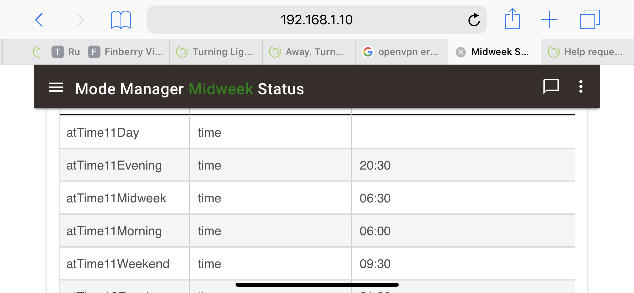

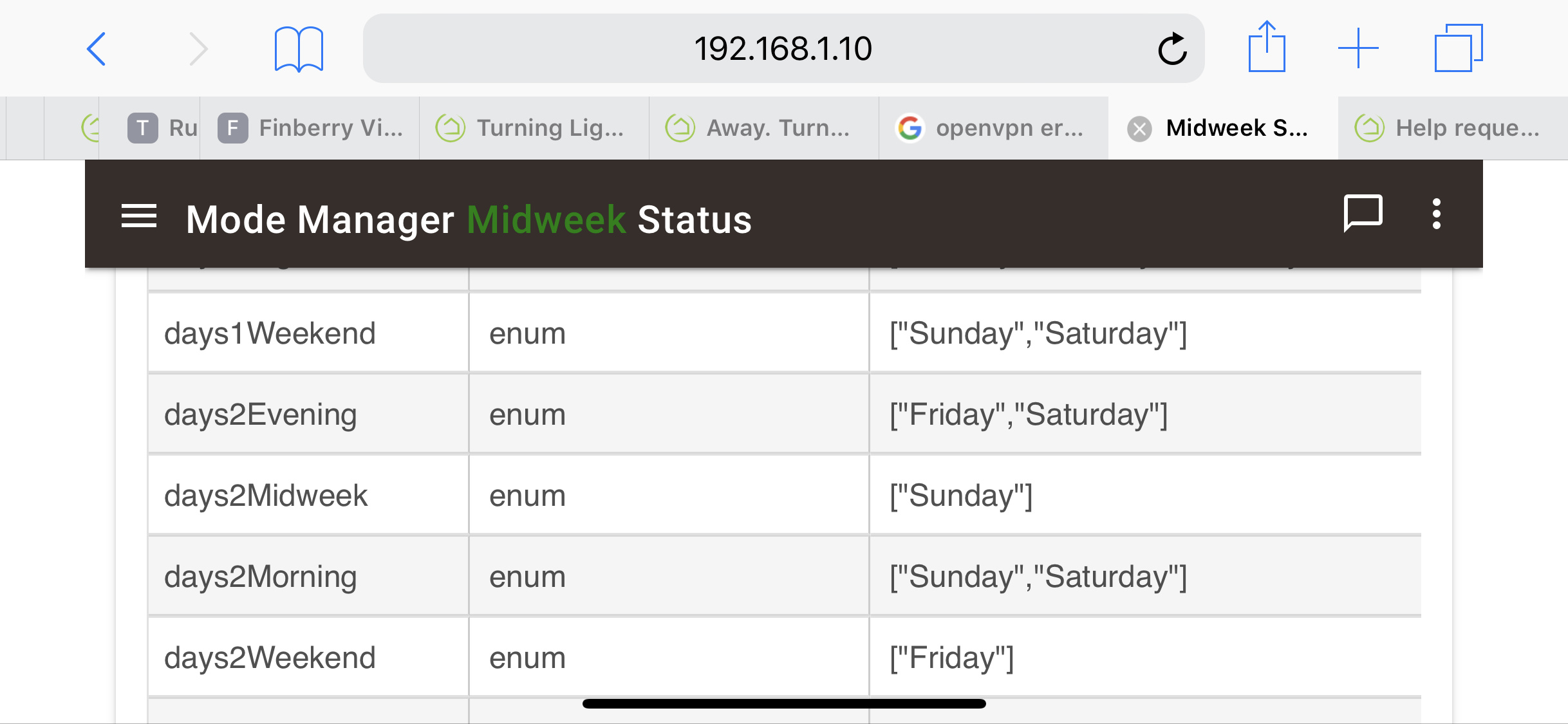

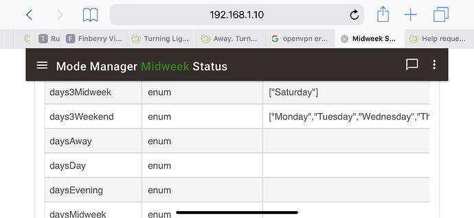

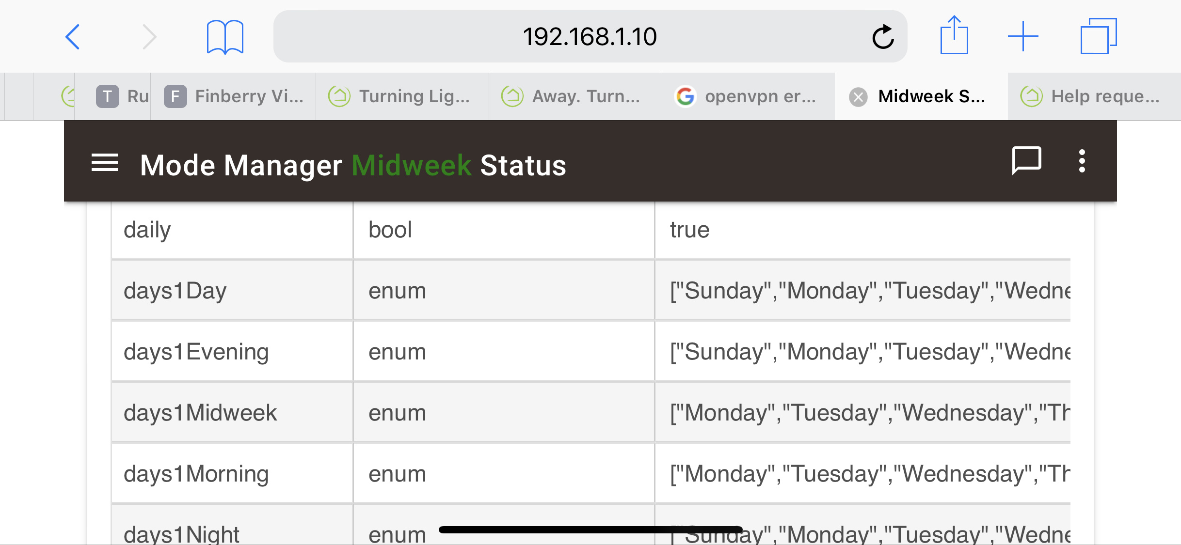

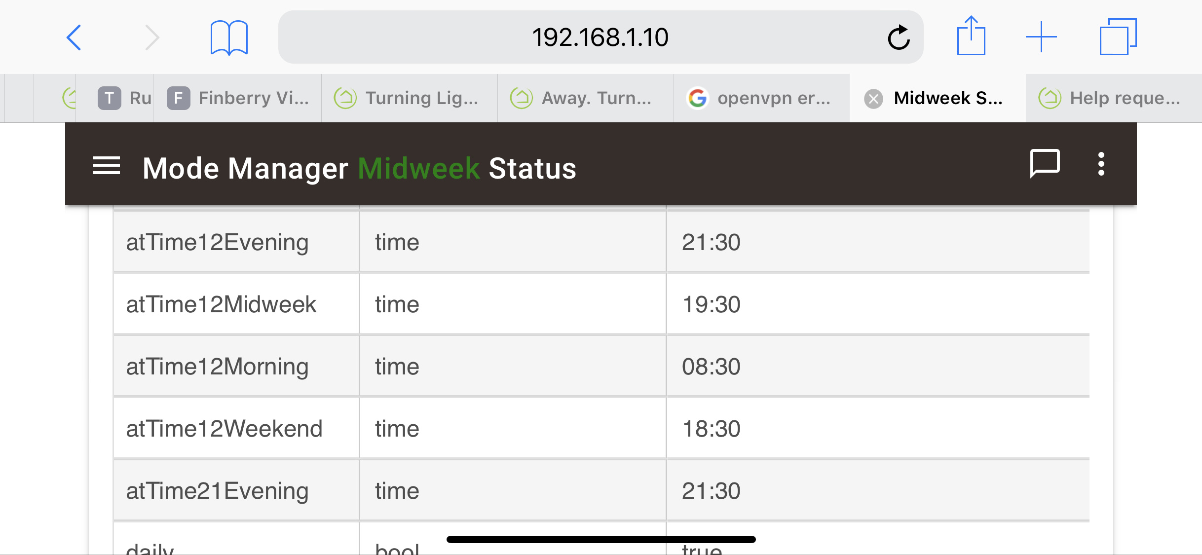

Could you take a screenshot of the App Status page (click gear icon on the Apps page for Mode Manager).
@bravenel Yes, should have gone to midweek. There’s a lot of screens - I can take all of them if you want? I think these ones are the important ones though?
Could Hubitat be getting confused as I start midweek on a Sunday at 7:30pm?
Actually, when I think about it, I could probably remove midweek mode on Sunday evening and weekend mode on Friday evening. I’ve copied them out of ST and implemented them before I created an Evening mode to dim Evening lights at different times in ST. Guess I just never revisited the timings (it’s just to help calm the kids down for having dimmer lights lol) and Friday allowing the kids to stay up later due to it being a weekend so they could go nuts for later in the evening lol
Deleting the app and adding it back and configuring times again seemed to work. I did remove Friday evening time for weekend mode and Sunday evening time for midweek mode and all seems good
