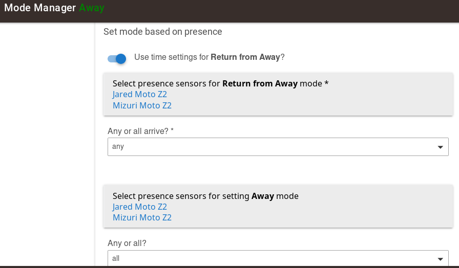

I'm trying to figure out what I am doing wrong here. All I know I did was change my presence "sensors" from the life360 I was using (which was working), to the hubitat app ones.
My mode still changes to away when everyone (both of us) leaves, but does NOT change out of away mode when one or both return.
Nothing below this is set.
These two presence sensors are currently showing present, so my understanding is the mode should have changed back to the normal modes.

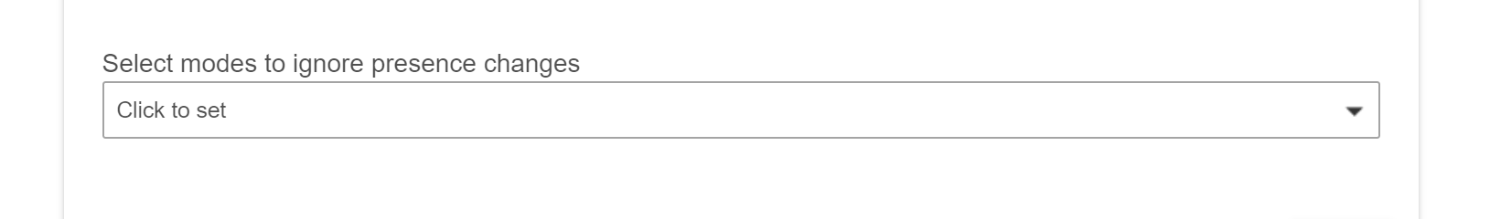

Do you have anything listed at the bottom under "Select modes to ignore presence changes"?
Do you also have time of day set for Day/Night mode? It might not be able to figure out what mode to return you to if you don't.
No, as I stated, "Nothing below this is set." That section has no modes selected.
Is this what you are referring to? Why would it work with the life360 presence and not the hubitat app one? I think I'll try setting it back to life360 for tomorrow to see if it works again.
