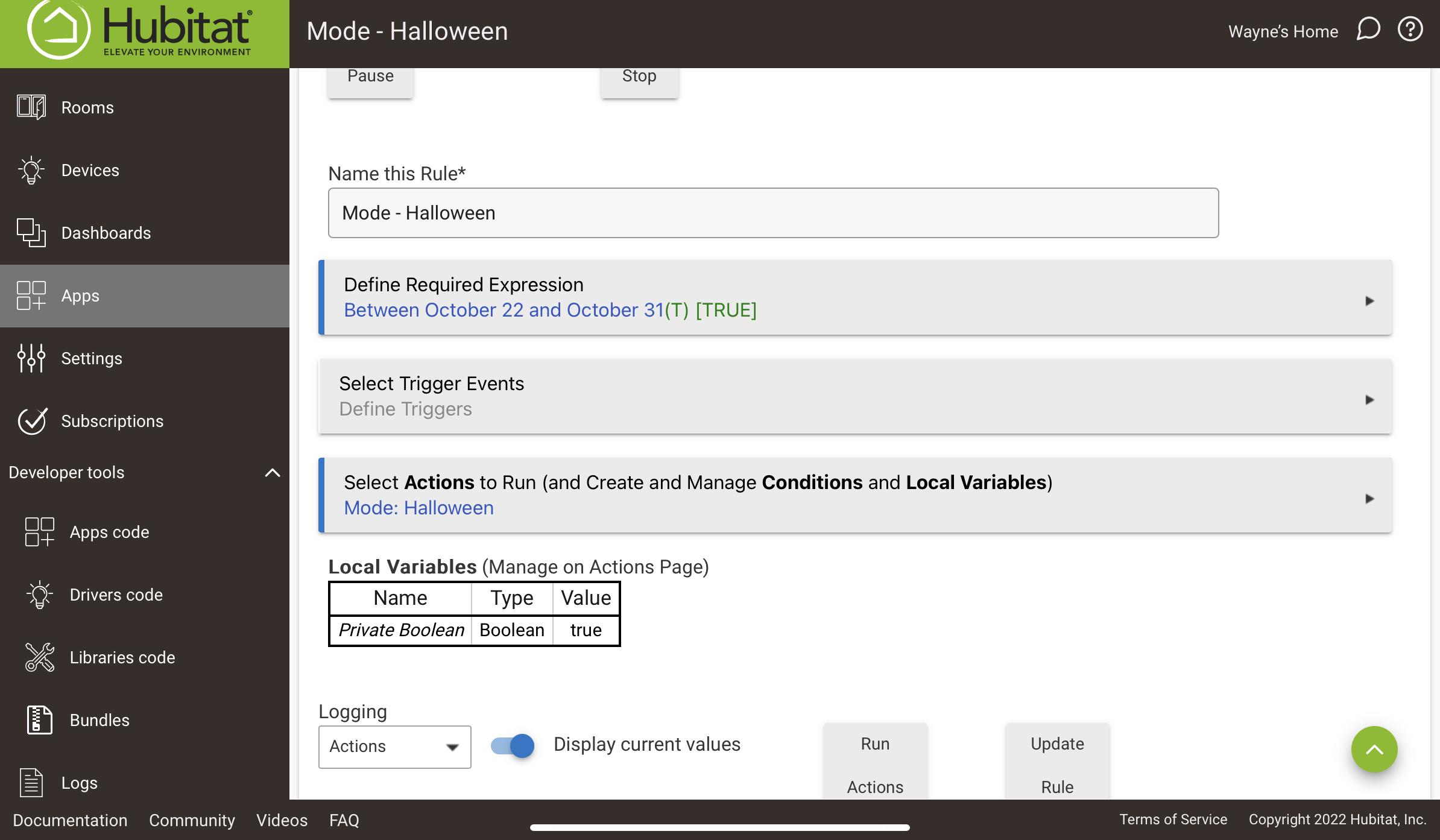

I created a rule called Halloween and its suppose to put HE in Halloween mode.
It said the RE is currently true and the action

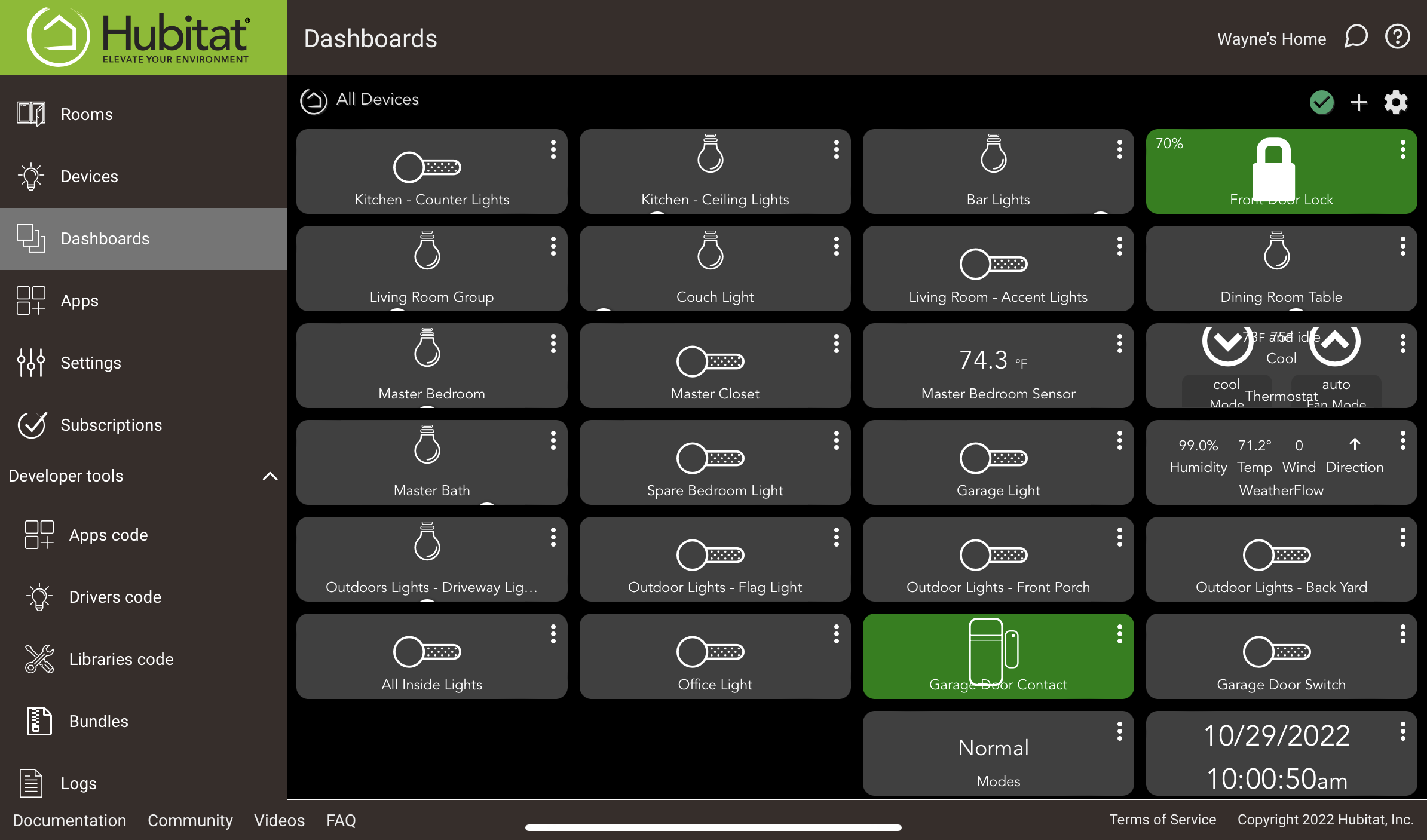

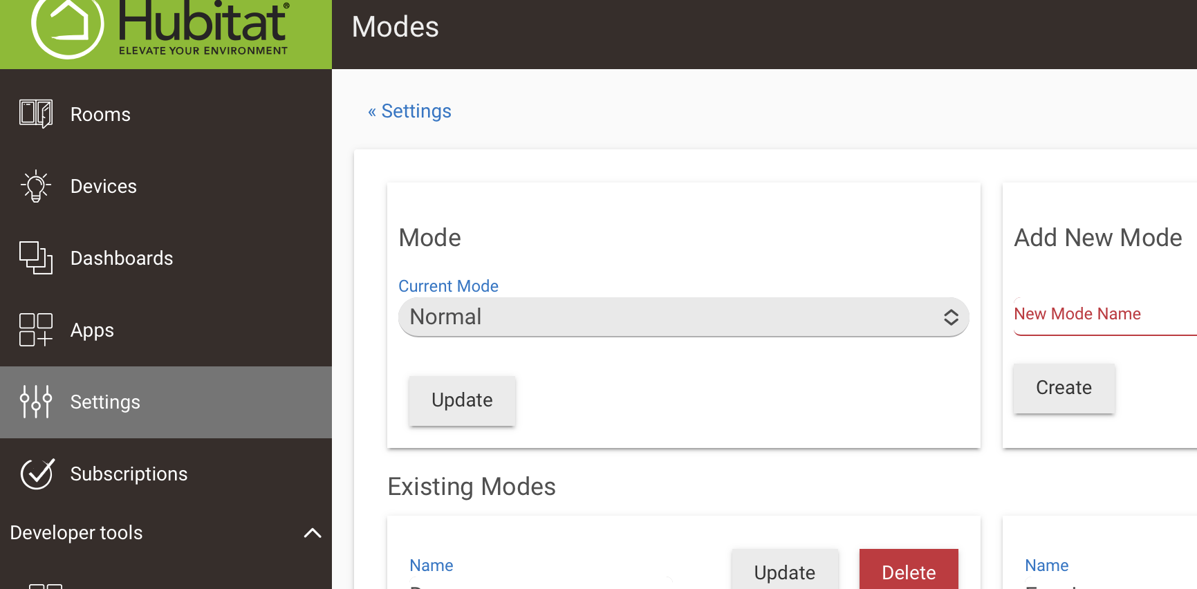

But according to the dashboard and in settings mode it said the HE is in normal mode..

First, there arenโ€™t any triggers to set the Halloween mode. The required expression is a restriction to the triggers. It basically tells the hub to only react to the triggers for setting this mode when Require Expressions are all true.
Secondly, you will need to look at the other modes (Evening?) to see what triggers them. You may have to set required Expressions on them so they donโ€™t step on this one. If this in for Halloween lighting, you may only need to add a required expression to the Evening mode that is the counterpoint to the Halloween Required Expression (e.g., between Nov 1 and Oct 21).

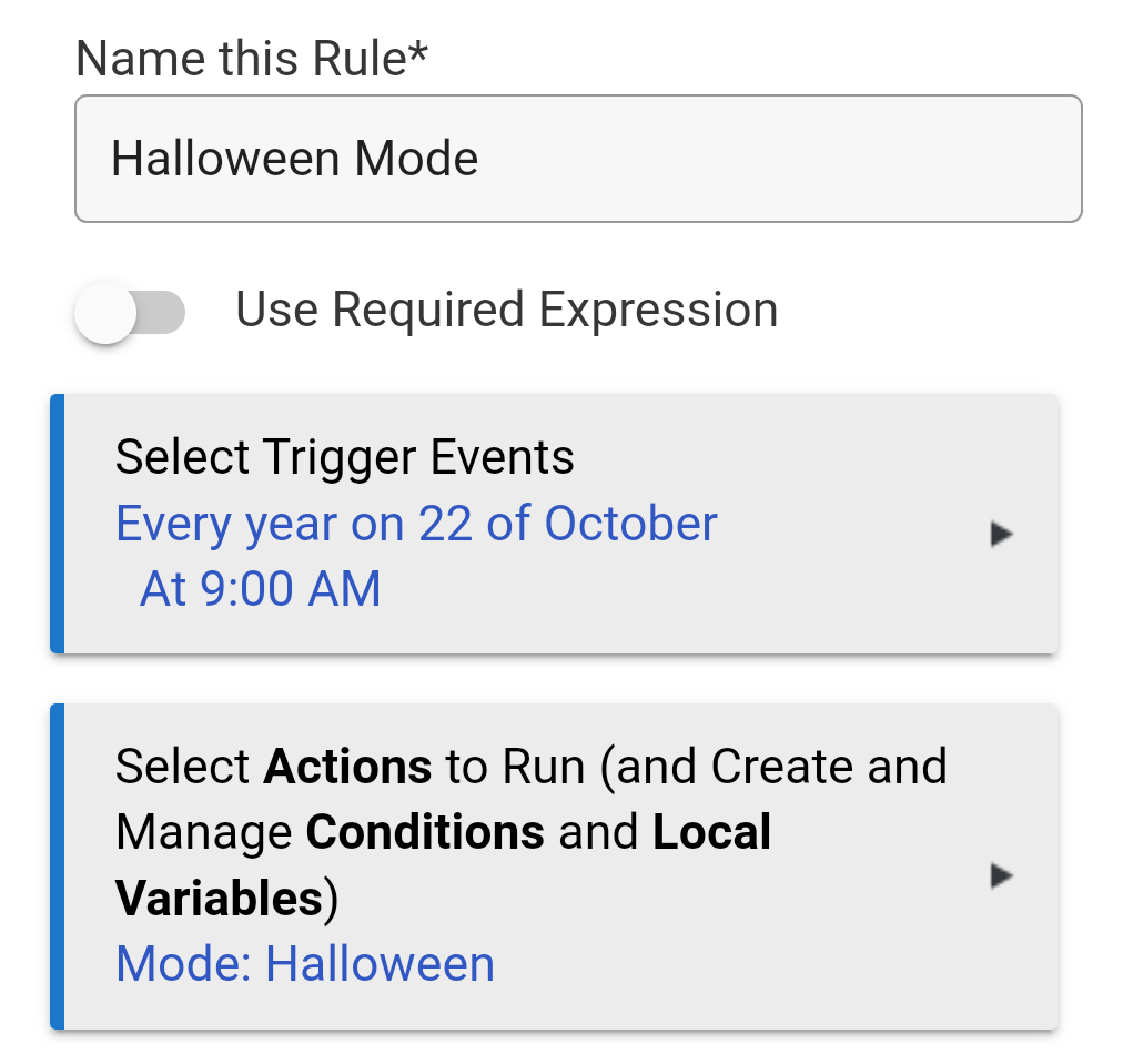

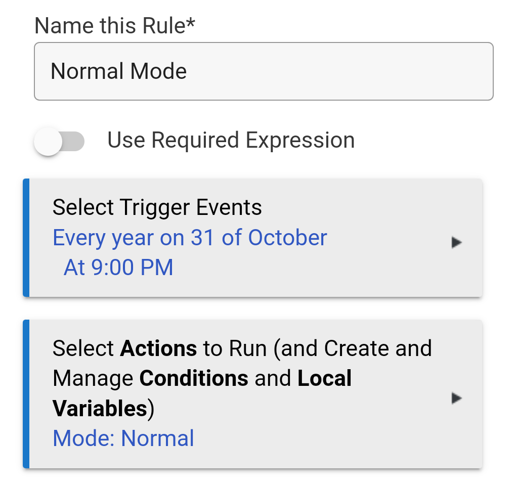

Well crap I thought the action changed the mode. So I have to update all 3 rules.
I assumed that trigger meant what triggered the action not that that was actually going to perform an action or
