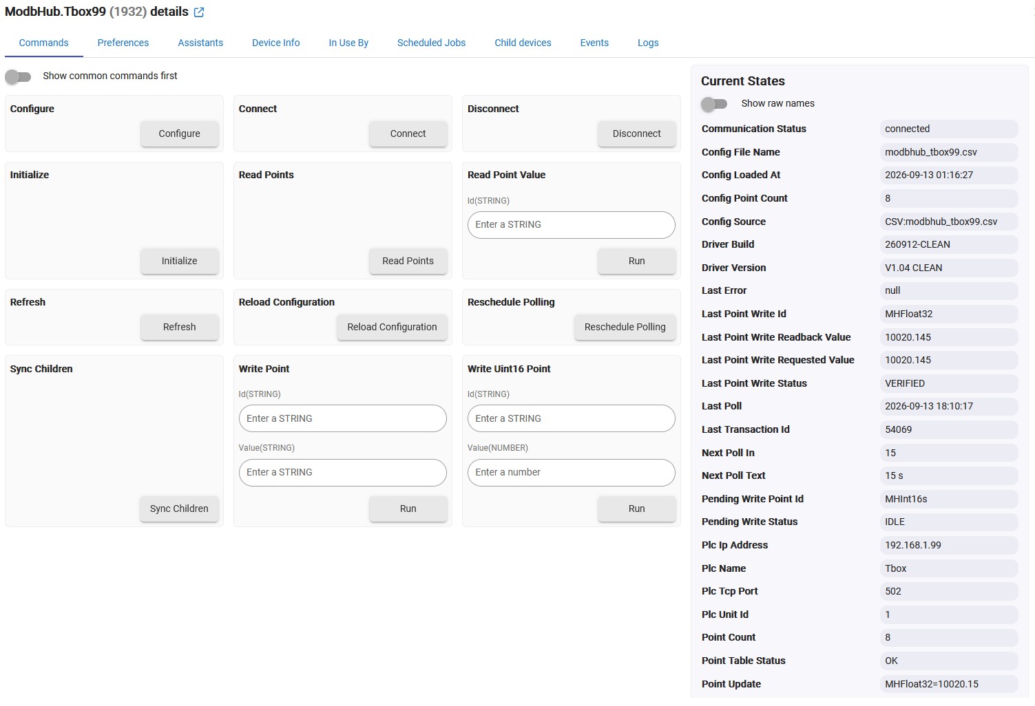

Update — MODBHub V1.06 Community Release — September 26, 2026
A new V1.06 Community Release is now available.
Since the original Community Release, MODBHub has continued to be tested on several simultaneous PLC instances and on different hardware, including Ovarro TBox and Temco controllers.
The main addition in V1.06 is much more robust handling of PLC/network failures.
MODBHub will now:
  • automatically detect a lost Modbus TCP connection;
  • suspend normal polling while the PLC is unavailable;
  • retry the connection progressively at 5, 15, 30, 60, 120 and 300 seconds, instead of continuously hammering the Hubitat hub and the network;
  • after TCP communication is restored, wait for a 20-second stabilization period before resuming Modbus polling;
  • automatically return to normal operation if the PLC comes back during the recovery sequence;
  • if all automatic reconnect attempts fail, stop retrying, report the communication error and optionally send a Hubitat notification;
  • expose a reconnectRequired state and a manual Reconnect command for controlled recovery after automatic retries have been exhausted.
The idea is simple: recover automatically from normal temporary network problems, but don't retry forever when something is genuinely broken.
V1.06 also consolidates the current MODBHub feature set:
  • BOOL, INT16, UINT16, INT32, UINT32 and FLOAT32 point types;
  • FC01 / FC03 / FC04 reads;
  • FC05 / FC06 / FC16 writes where appropriate;
  • configurable scale, offset, decimals and 32-bit byte/word order;
  • grouped polling of compatible contiguous registers;
  • one authoritative Modbus transaction in flight per PLC;
  • write coalescing and targeted post-write readback/verification;
  • read-only (r) and read/write (rw) point protection defined in the CSV;
  • multiple independent PLC/Modbus endpoints, with one MODBHub Parent per endpoint;
  • optional bidirectional Hub Variable integration through the MODBHub Binding App.
The package has also been cleaned up so that the Parent, all six Group Child drivers, Binding App and Failure Notifier are now consistently identified as V1.06, and the archive includes the complete installation and reference documentation.
The current V1.06 package has been installed as a complete update on my Hubitat C-5 running firmware 2.5.1.183, reboot-tested, and is currently running several PLC instances simultaneously.
It has also been successfully tested on a Hubitat C-7 running firmware 2.4.3.137, providing some additional confidence that MODBHub is not limited to the latest Hubitat firmware generation.
I am still very interested in tests with other manufacturers and Modbus TCP devices. Real-world testing outside my own hardware is much more valuable at this point than adding features simply because they are possible.
So the original invitation still applies:
Test it, challenge it, break it, and tell me what you find.

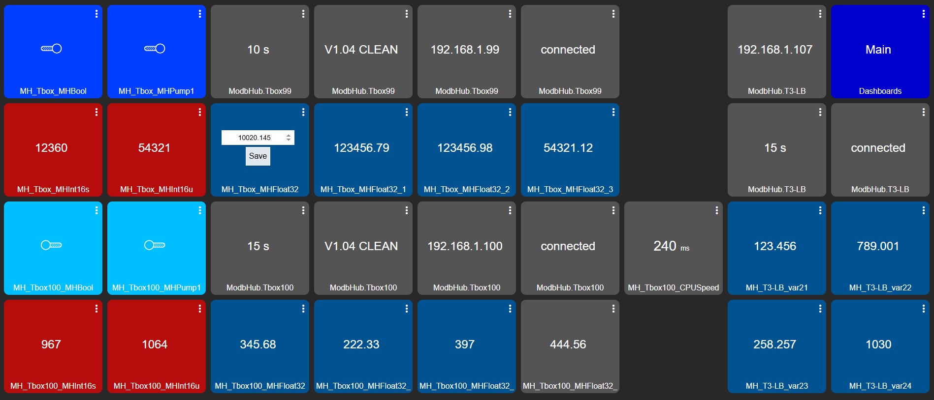

Small MODBHub update
MODBHub has now been successfully tested by a Community user (EVOLVING.HOME) with a Moxa ioLogik E2210. Bidirectional communication was confirmed: Hubitat can control the E2210 digital outputs and correctly read its digital inputs through normal polling.
This is particularly nice to see since the E2210 was not part of my original test hardware, and provides a first external validation of MODBHub's generic CSV-driven approach.
I've also placed a small V1.06d update in the download archive. It improves recovery after a communication failure by adding a contextual manual reconnect command once the automatic reconnect sequence has been exhausted. A manual reconnect is a one-shot attempt: if it fails, MODBHub remains in the stopped state and allows another manual attempt, without restarting the complete automatic backoff sequence.
Thanks to Steve for testing it on real hardware and for the useful feedback!
