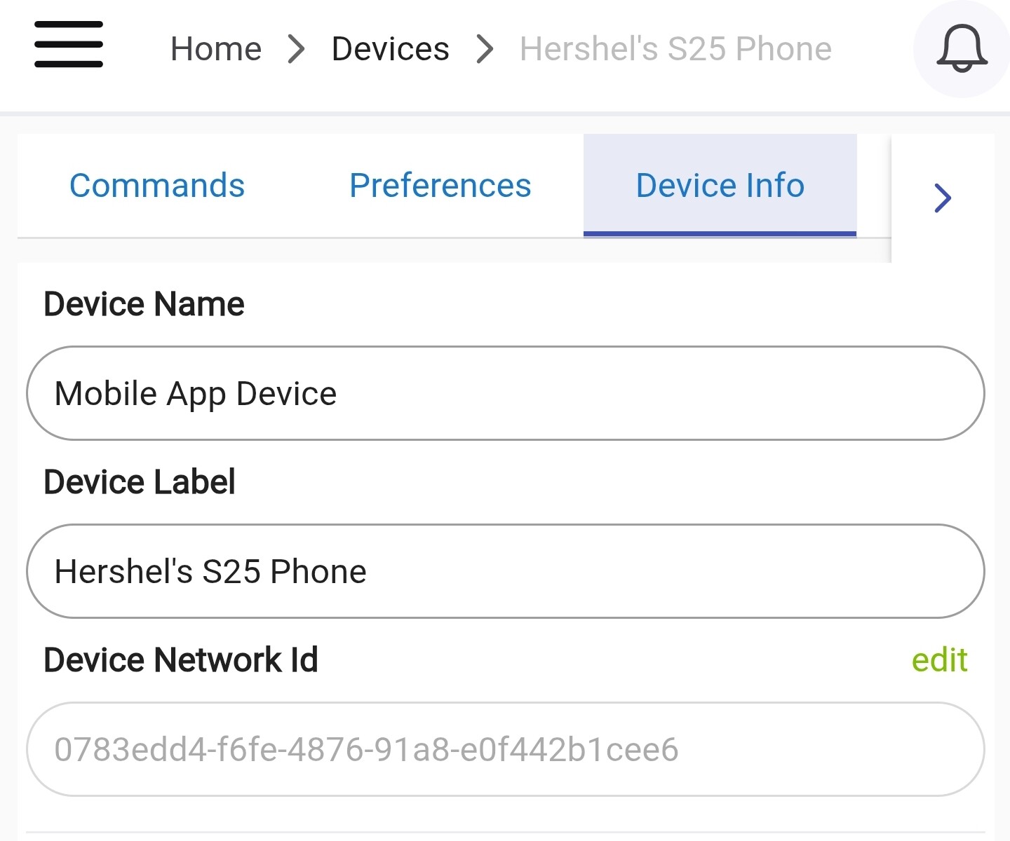

I used to have a Galaxy S22 and I used the mobile hubitat app with geofence to track presence. It worked well. Just switched to a Galaxy S25+ phone, and installed the same app, same login, same settings. The app shows me as in/out of geofence correctly, but it doesn't communicate that to the hubitat hub. I deleted the old device for my S22 and created a new S25 device as "mobile app" device. Still nothing. I must be missing a step ... Any help would be appreciated

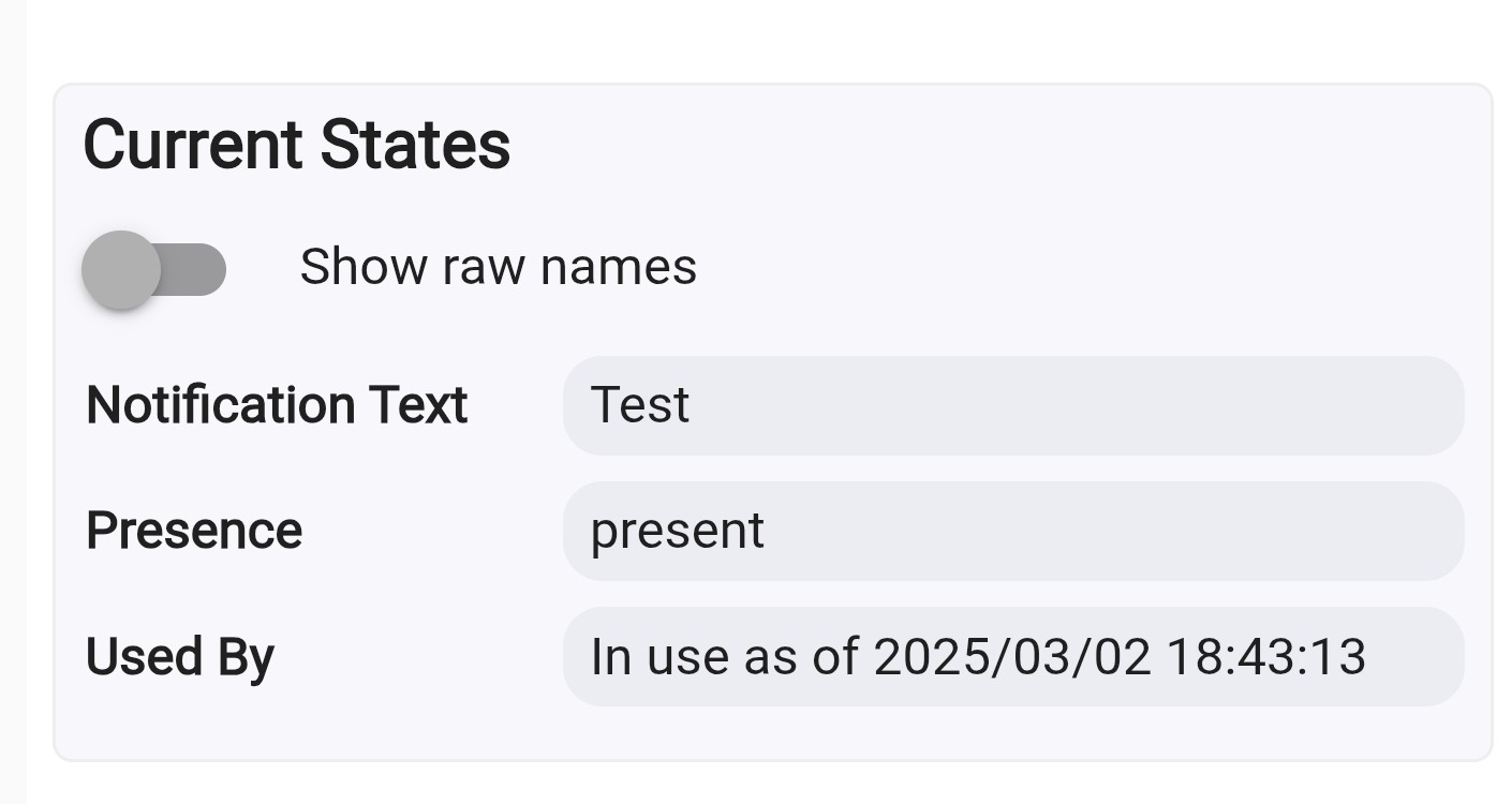

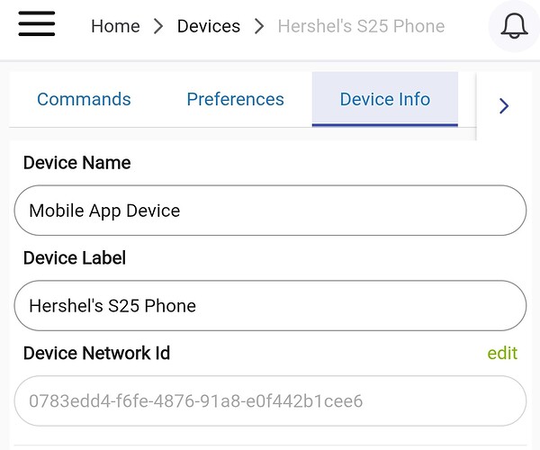

Fixed the problem. Somehow I was manually creating the device rather than letting the system create it. I deleted the device, then logged out of the mobile app. When I logged back in, it created the device correctly and notifications and presence reporting now works.
