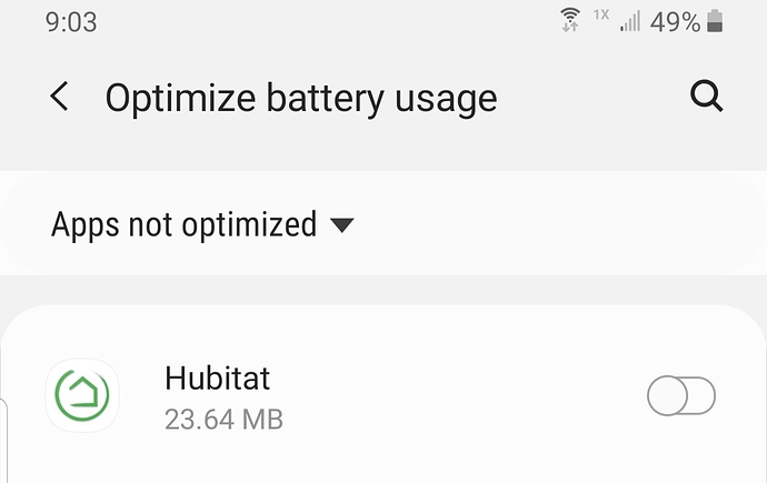

Make sure the app is not optimising battery usage and also that it cannot "sleep". You can set these in settings, app and settings, battery... well, on my Samsung S8 Edge it's possible :slight_smile:
Hope it helps.

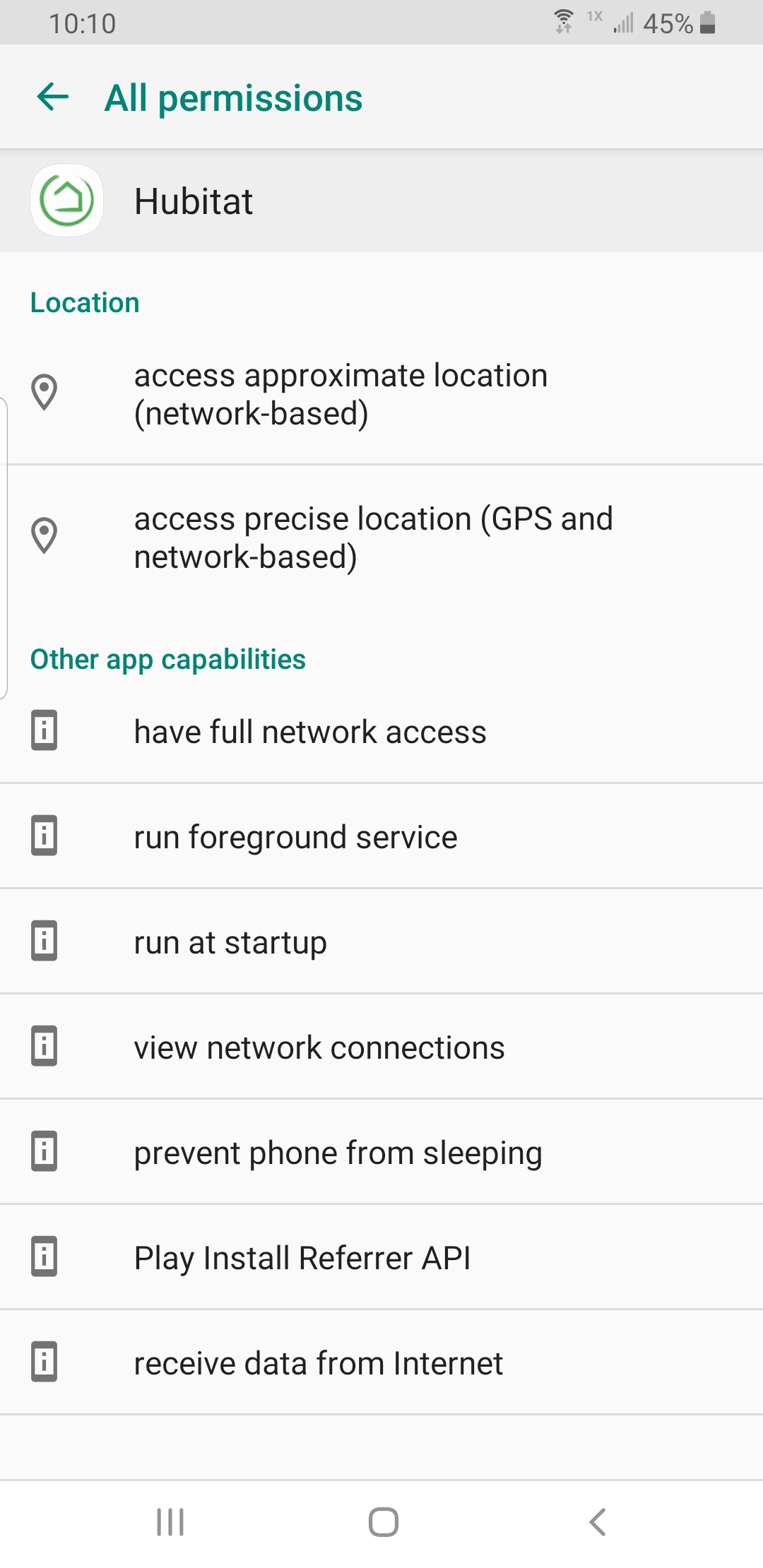

@Angus_M Since it works on your S8 can you screenshot your app permission page for Hubitat and post? I want to compare to mine (see above).
