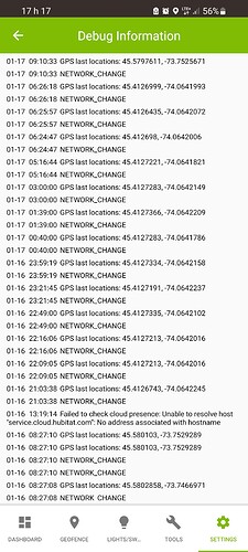

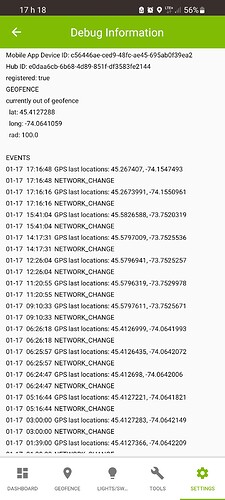

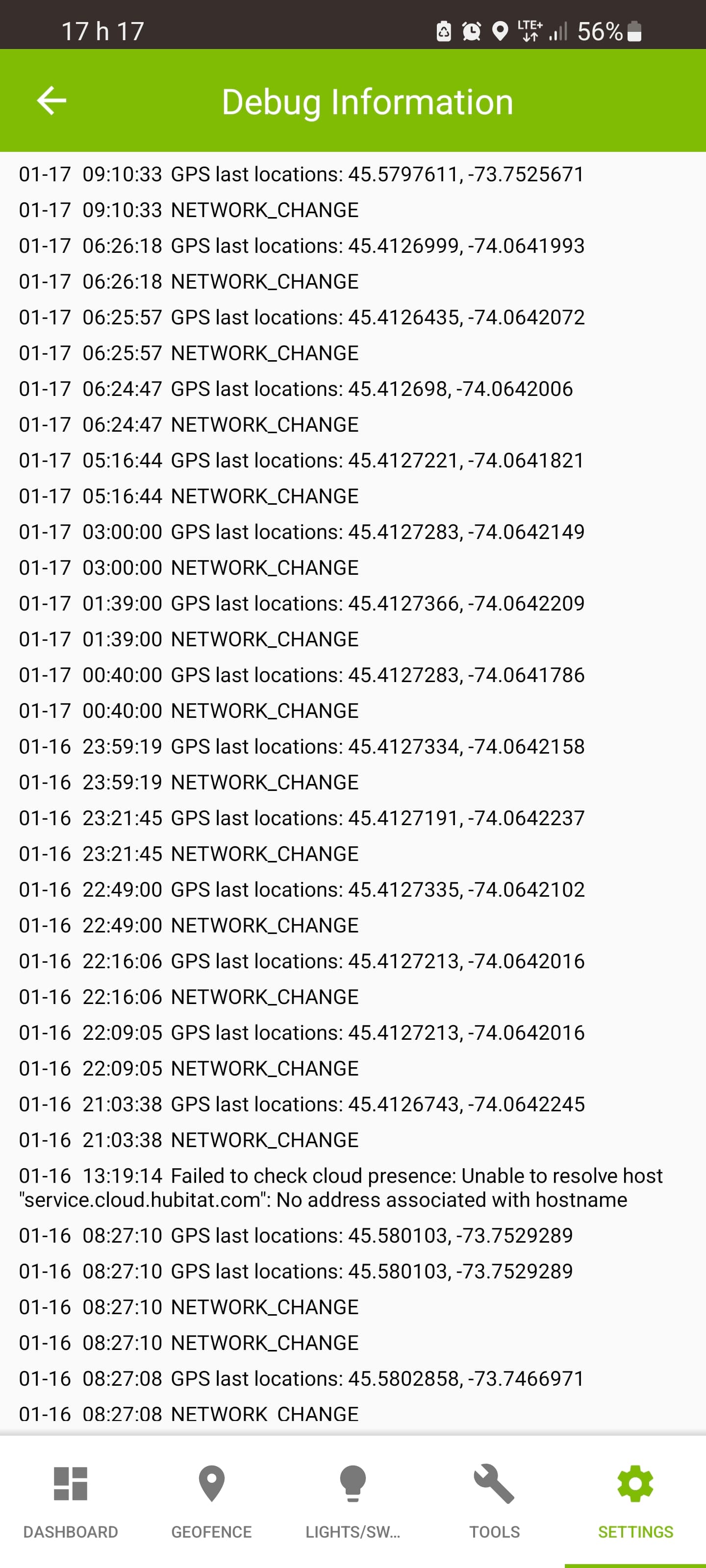

Hello Simon
i'll try the parameters you suggested but still not working.
you can see here the information of the event m the system saw me out of the geofence but still be green like if i'm still at home.
Best Regards
