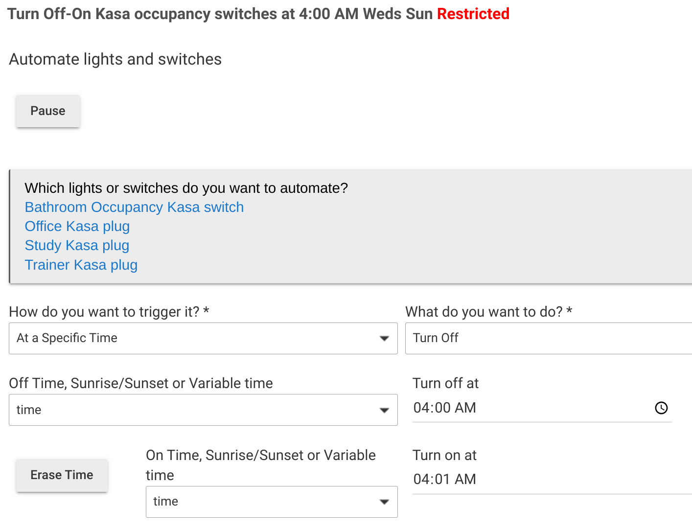

I have four of these, two Linptech and two Moes, Aliexpress and Amazon, same thing. Two had no drop out history, the other two were a random two to three weeks. I tossed a cheap Kasa plug in front of all of them and selected twice a week for a very brief middle of the night off/on event twice a week for no carefully determined reason and have not experienced a dropout since. This was almost a year ago.
Same except used the SonOff EweLink plugs and power cycle once a week at 3am or so, and never had any problems since.
