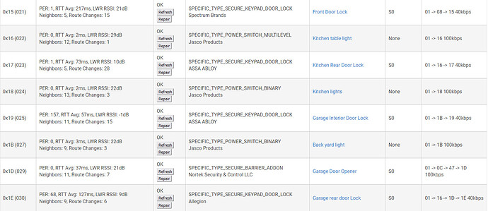

What lock? Can you post your z-wave settings page in it's entirety?

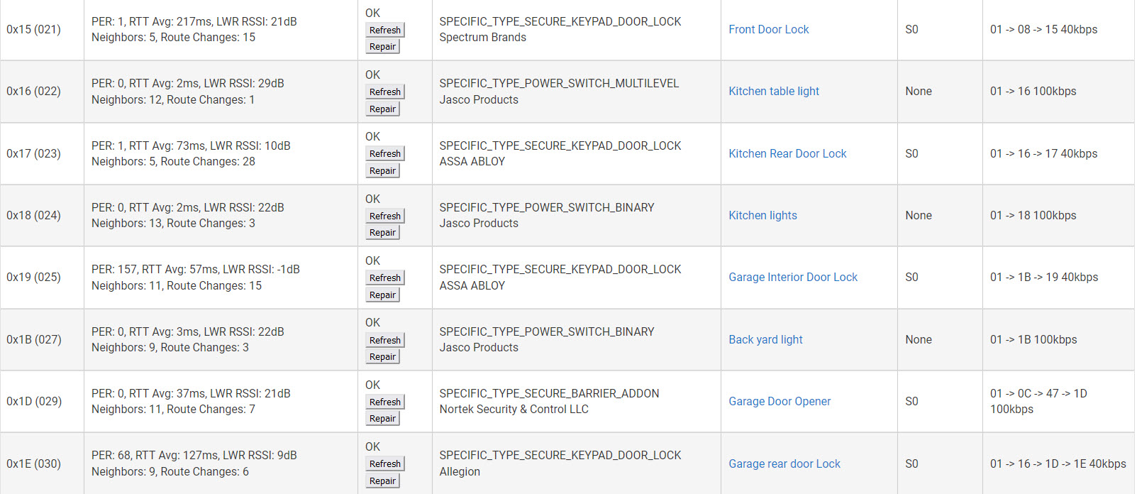

The Garage rear door lock is not communicating that well. The PER is 68, RSSI 9, and Route Changes 6.
Compare that to what Z-wave says about that.
The 2 that are the worst are garage rear doorlock and garage interior doorlock. There is a brand new zwave plus ge enbrighten toggle Garage light within 4 ft of each of them
