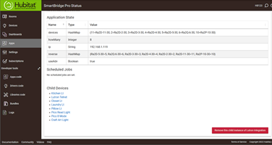

And here's some pics of the Hub Lutron Integrator "gear" settings, pages. There is no "file" section, as I saw in someone else's post:
continued:
and last part:

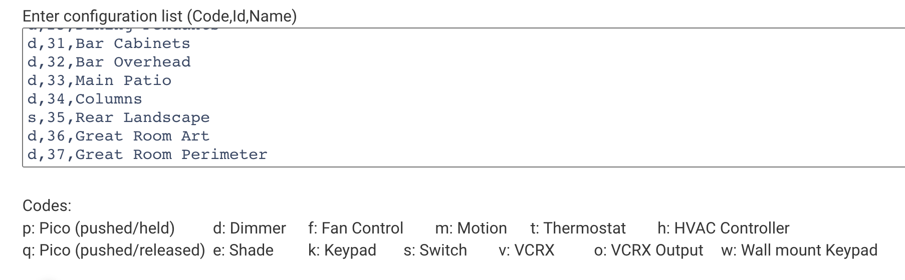

Each entry in the list looks like this:
No spaces in each entry (after commas): the code, the integration id, the Hubitat name (can have spaces in it).

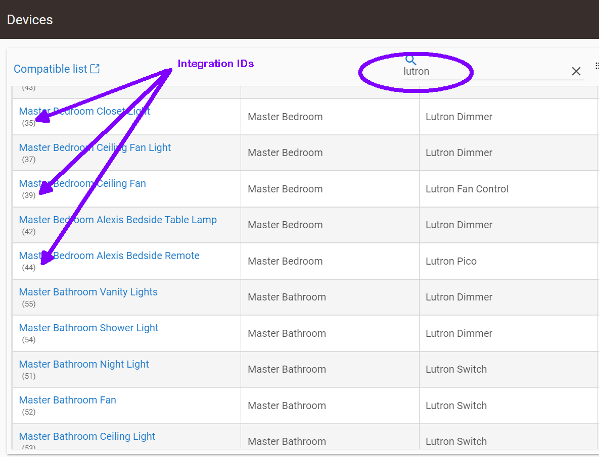

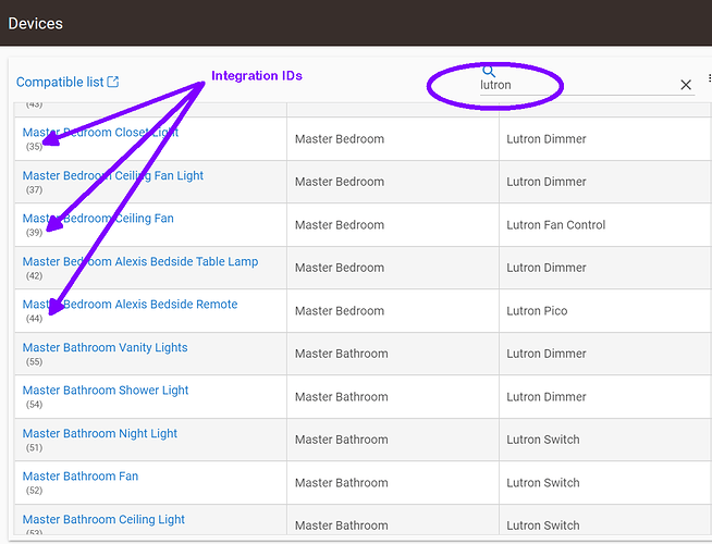

The integration ID shows up under the label name assigned when you list your devices. You can list the devices and put Lutron in the search box - that will get you the data you need to recreate your list.
