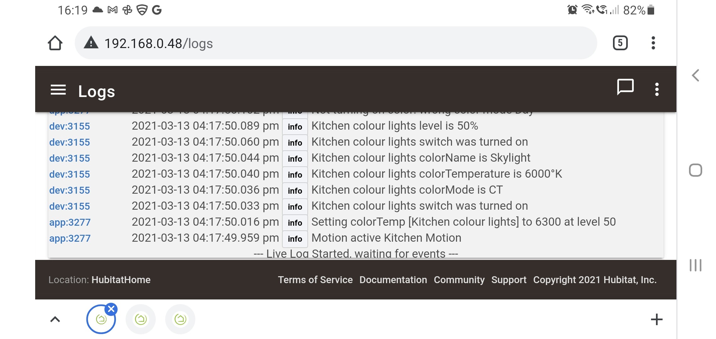

im tring to understand why not all commands are forwarded
colorMode, color, RGB, colorName are all processed events by the driver as a result of the commands that are forwarded..
Problem I'm having is the virtual controller isn't sending commands if it thinks it's has the same settings.
Ie
ML app sets virtual device to 5000k CT,
Manually set virtual device to a colour
Lights turn off
When the ML app runs again on motion it only turns the lights on (at the last rgb colour) not the CT which it's set up to do.

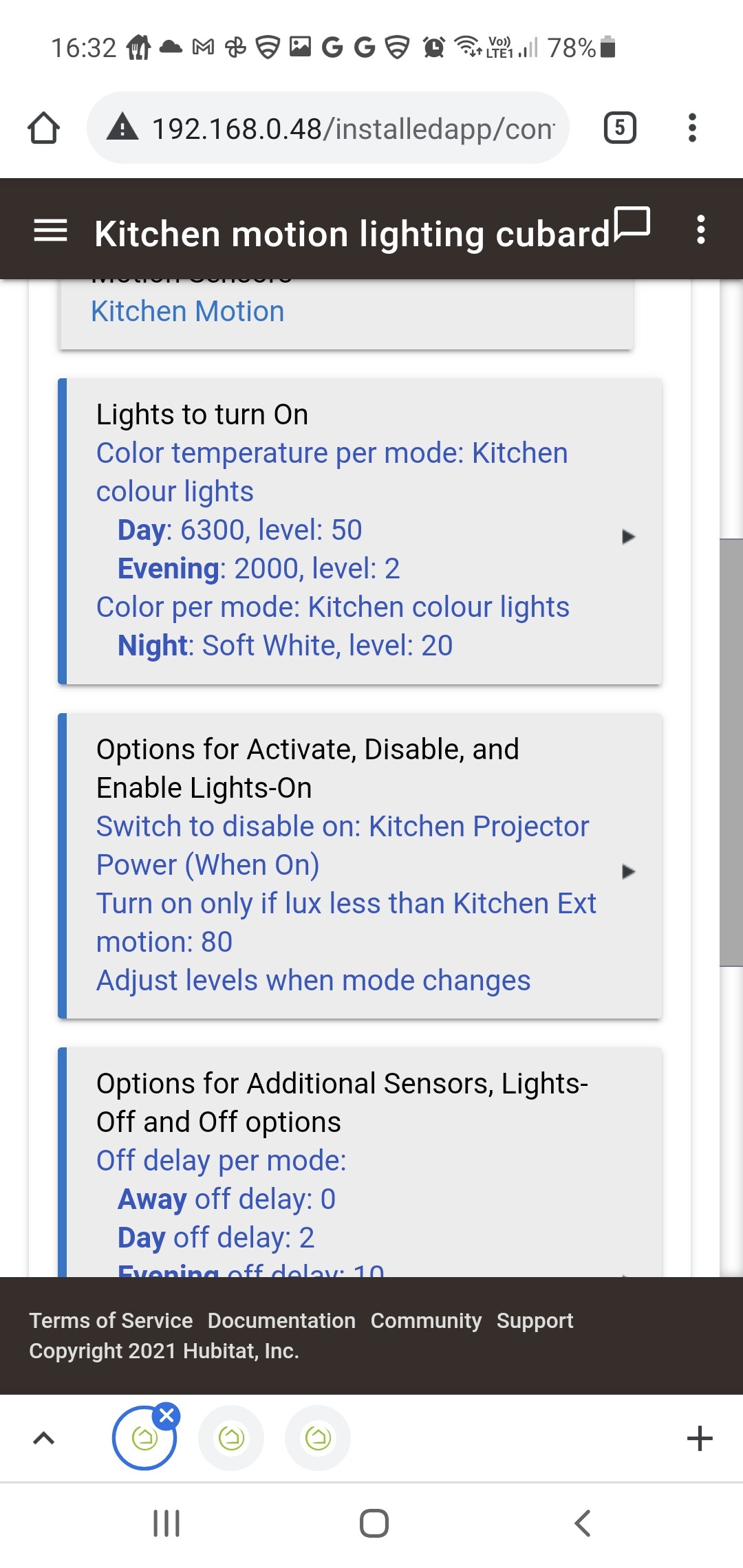

Can you post a screenshot ?
But the lights only come on in their last state which was rgb, its like the mirror app filters everything but the on off
Right.. sorry.. I meant the ML settings for the screenshot
Did you get chance is it mirror app or the virtual rgbw driver?
