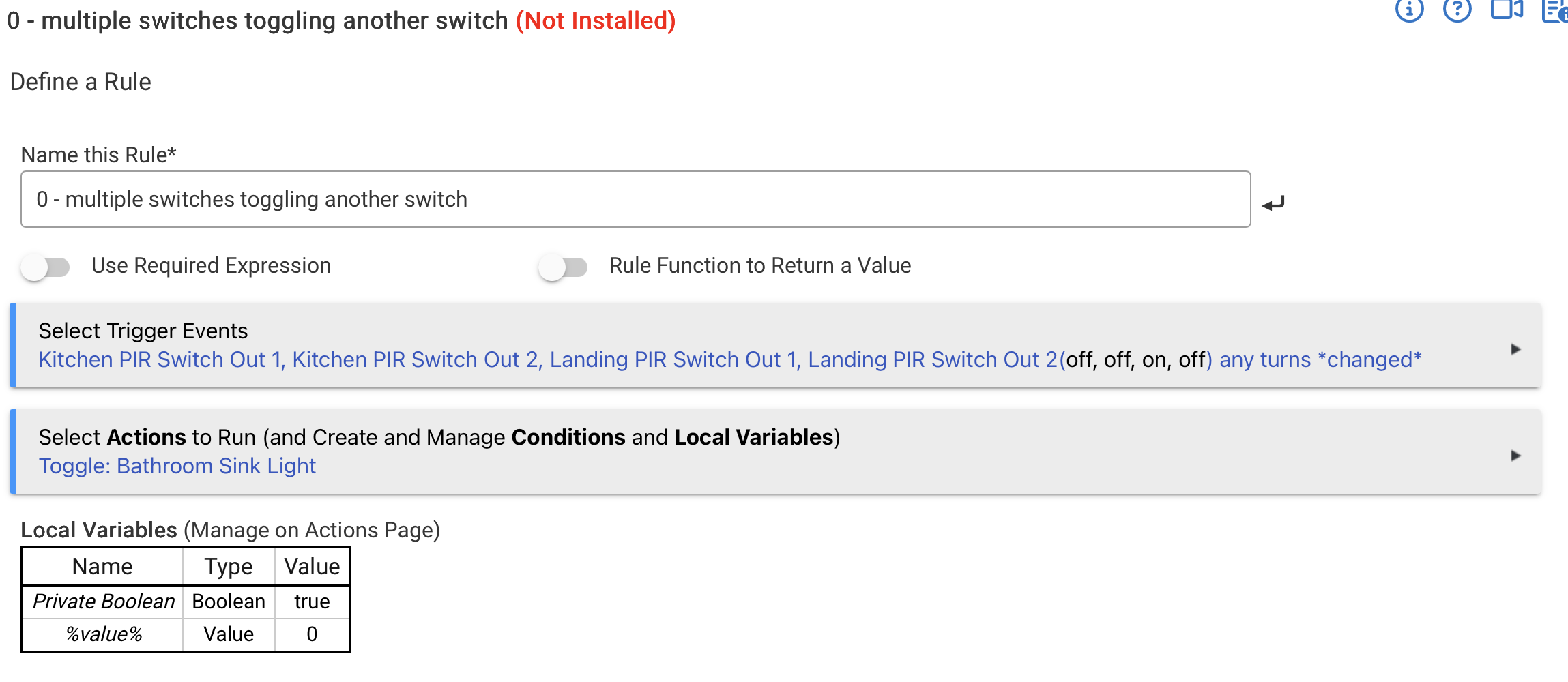

@youra It sounds as though you should to be able to do it easily in Rule Machine.
Trigger - the remote switches changing
Action - toggle the switch that is wired to what your trying to control
Like this:
Any of the switches changing state will toggle the actioned switch irrespective of its current state.
Wowsers!
Thanks - that's worked a treat :slight_smile:
Now - how did I miss that?? I knew it should have been relatively simple!
