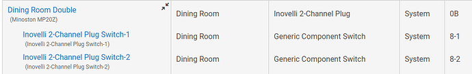

I've added the Minoston MP20Z (Dual plug outlet, also on the CDL), it shows up on Hubitat Devices, works fine in the dashboard (I can turn it on/off with Tiles) but won't show up on Homebridge Accessories no matter how many times I bounce the HB. And since it isn't showing up in Homebridge, it doesn't show up in Home App on my phone.
Other than removing it and reinstalling it, I haven't dont much else and I've spent a lot of the day moving stuff off my Smartthings hub to Hubitat (my brain hurts).
anyway, send me ideas please. Attached is a pic of the device.
