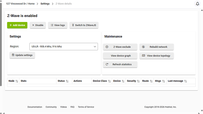

Does Zwave Details show any devices? Screenshot?

No devices showing (screenshot enclosed). I did shutdown the first time (cloud version), but the second & third restore was local so
if the z-wave data isn't in the local backup then i need to reload from the cloud?
Yes, only the cloud backups have the full radio data too (locals do not)
