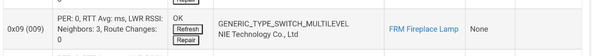

Your 2nd row is missing a Route.
Ordinarily we see those and think: "Ghost" -- meaning a device that only partially Joined.
Also, normally, we see the next device is a match/duplicate of the ghost and thus tells us you got a failed Join and then tried again, and succeeded on the 2nd attempt. You don't have that, but it maybe you just haven't noticed yet. :slight_smile:
Next I'm going to focus on the last row:
Notice that there are Remove and Replace buttons that don't exist anywhere else. That means the Hub has detected the device no longer exists. Could be powered off, or out of range of everything. But it isn't good either.
Can you tell us more about those two devices?

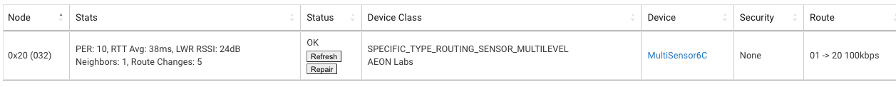

Well it's the same issue again today... The zwave screen looks ok...
However you can see no activity since this morning....

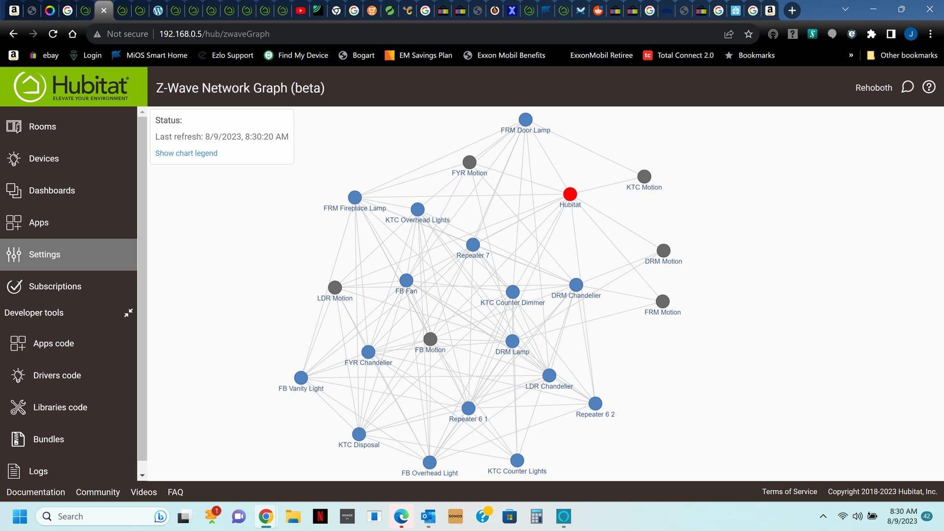

bobbyD, I did as you suggested last night, I added additional wired/plugged devices including three repeaters. All was working well last night. When I got up today, the same situation, the motion sensors are not reacting. I tested one device directly, and it works by manually turning it on, so I think it is just the motion sensors. I'll attach the Zwave details screens below.
Please let me know what are the next steps to get this and keep this working.
OK, really bizarre, as i mentioned I turned on one of the lamps manually through the dashboard while I was sending the last message. When I was done sending the message i noticed the other family room light went on. I checked the dashboard, and you could see the two lights and the motion sensor had tripped. So I walked around the first floor and the motion sensors tripped and the lights came on in the various rooms.
So, it appears that the Hubitat was "asleep" until i turned on one of the lights, I have no idea. This is really odd. Is there some setting I'm missing which would make the Hubitat unresponsive until some action was taken like turning on the light? or is this something else all together? any help would be appreciated.
