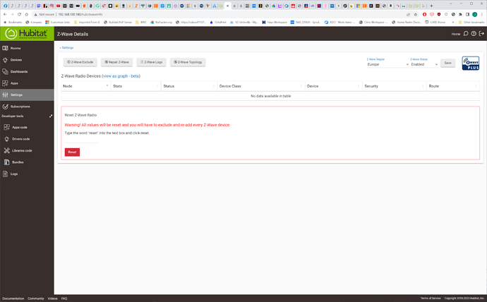

Powered down for 15 minutes. No z-wave details are showing up:

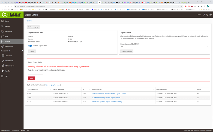

Zigbee

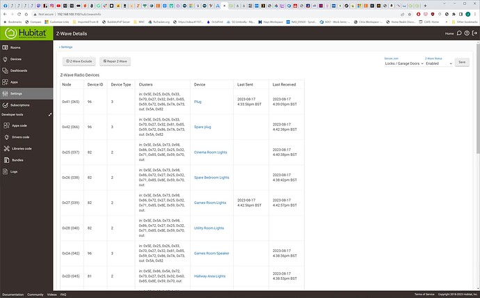

Z-wave

I've fixed the sonoff contact sensor, and it is reconnected to the zigbee network:
I've also checked every z-wave device, and they are all responding correctly. However, attempting to generate a backup still results in an incomplete state:
