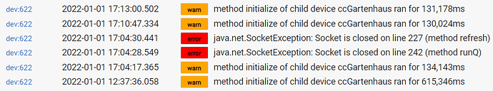

Lately I'm getting this error message several times a day. (BTW: I have not changed any app or device codes.)
I also notice that saving changes to device settings sometimes takes a veeery long time (e.g. a minute instead of the usual 2 seconds).
What can be the reason, how can I eliminate these problems?
(I already rebooted... no success!)

OK, there is one device (Chromecast Audio) that has much more % than normally (7% instead of 0.5%). The device is currently often without power (it's powered by an off-grid solar system). But there was no such problem last winter...

Today there were no events (and BTW no "it takes forever to save" problems) - but yesterday:
I'Ve never seen before timeouts that take more than 10 minutes!?!

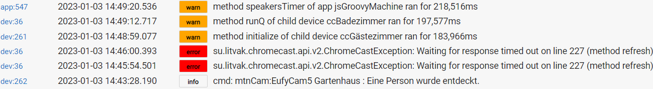

BTW: Those Chromecast Audio error/warn events arised again (2 minutes after I shut down again the power in the garden shed):
But after that I have not noticed any saving problems...
