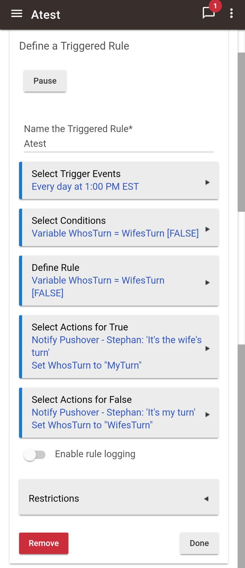

If you want to do this outside of Message Central with Rule Machine, I believe the triggered rule below should work.
The global variable does not need to be a string...I just choose it because it would be more descriptive of what's happening.
Looks good to me.
