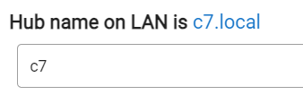

This is probably not causing your issue but do your hubs have different names allocated to them on the hub settings page.
I seem to remember people reporting issues because their hub names were identical.
Like I say, probably not the issue but it is something to cross of the troubleshooting list.
Thanks for the suggestion, I also modified the names to be different under Settings / Hub Details a while back. I can see where that might be an issue...
