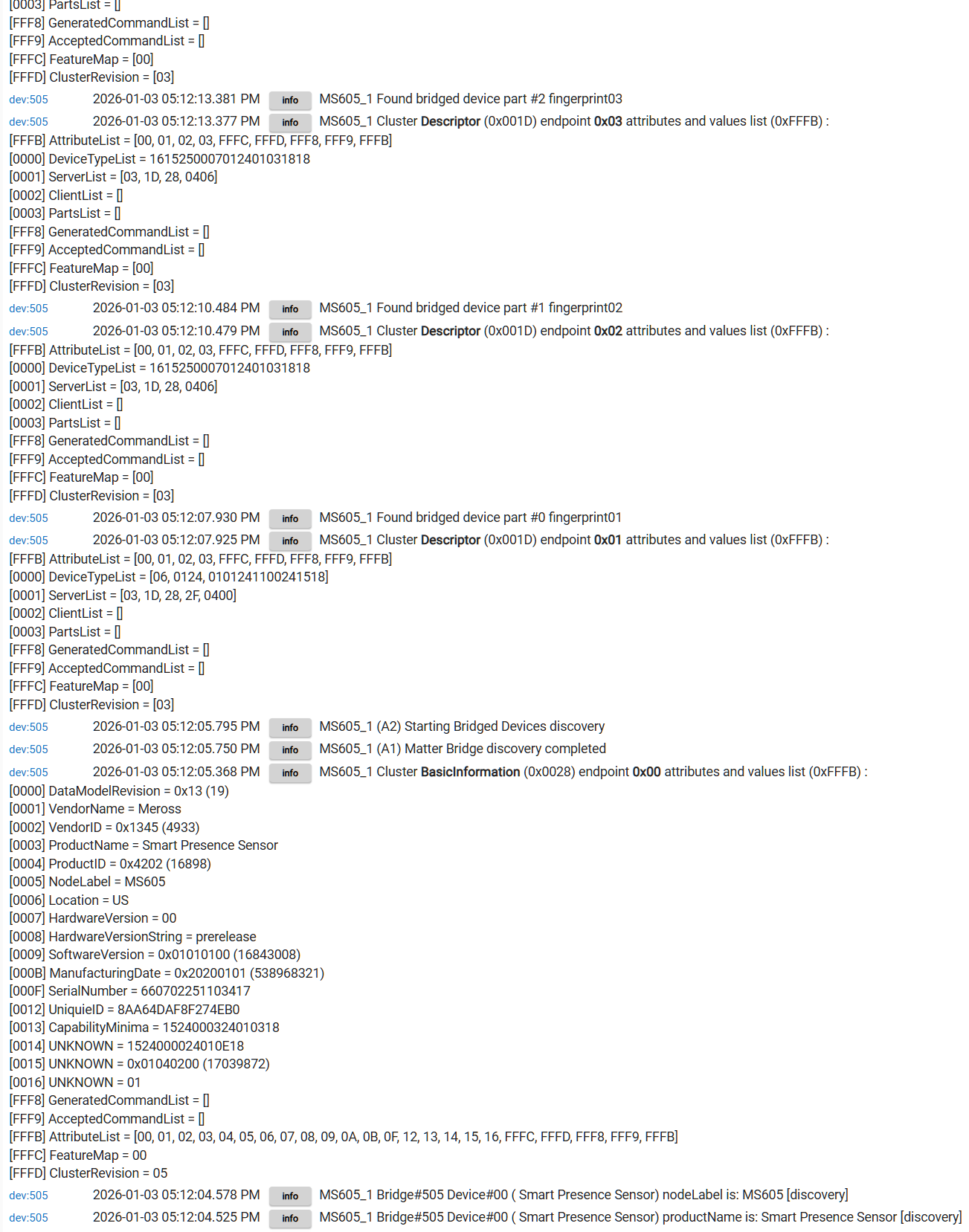

Just in case I tried @kkossev Matter Advanced Bridge driver. Unfirtunately you are correct, it does not work (i.e. nothing was discovered):
It looks like something is not quite right with Matter over Thread impementation.
My device was comisioned with Home Assistant and it works just fine in HA.
Gladly I can share it with HE via HADB. But maybe Kasimir can fix/update his driver at some point. Just in case here is a log (portion):

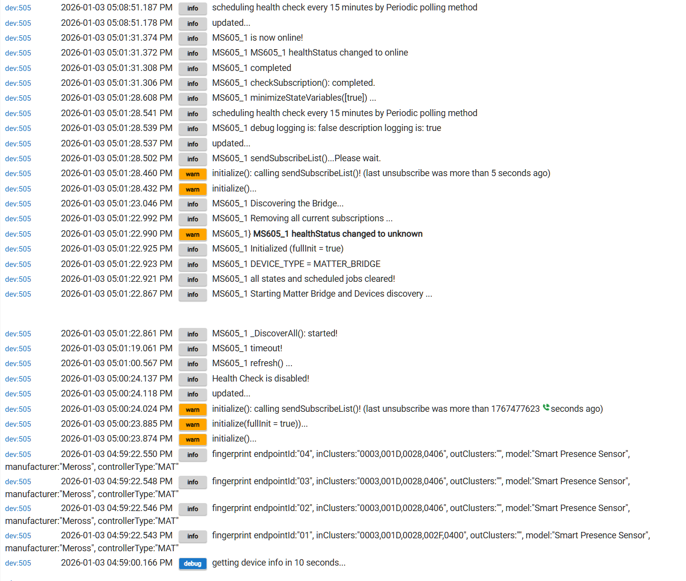

And one more:
UPDATE.

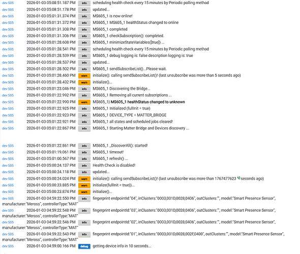

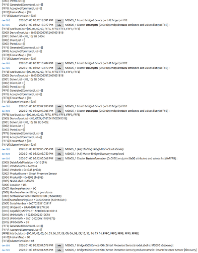

Just in case, cleared everything by temporary assigning DEVICE driver and that tried Matter Advanced Driver one mor time. Surprisingly this (second) time everything worked as expected:

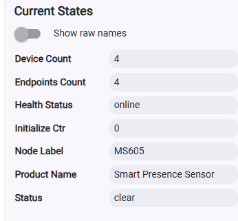

Four Chils Devices were created (Lux and 3 MS):
and they are 100% functional.
So, everything looks good on a second try. Who knows why it did not work on a firs try.

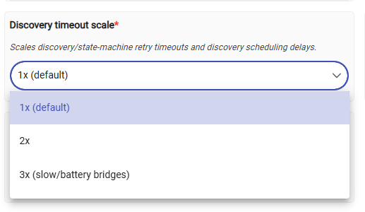

The problem with the Matter Advanced Bridge is that it was designed and tested to work with mains-powered Matter devices, and its timeouts are sometimes too short for the slow response times of some battery-powered Matter devices.

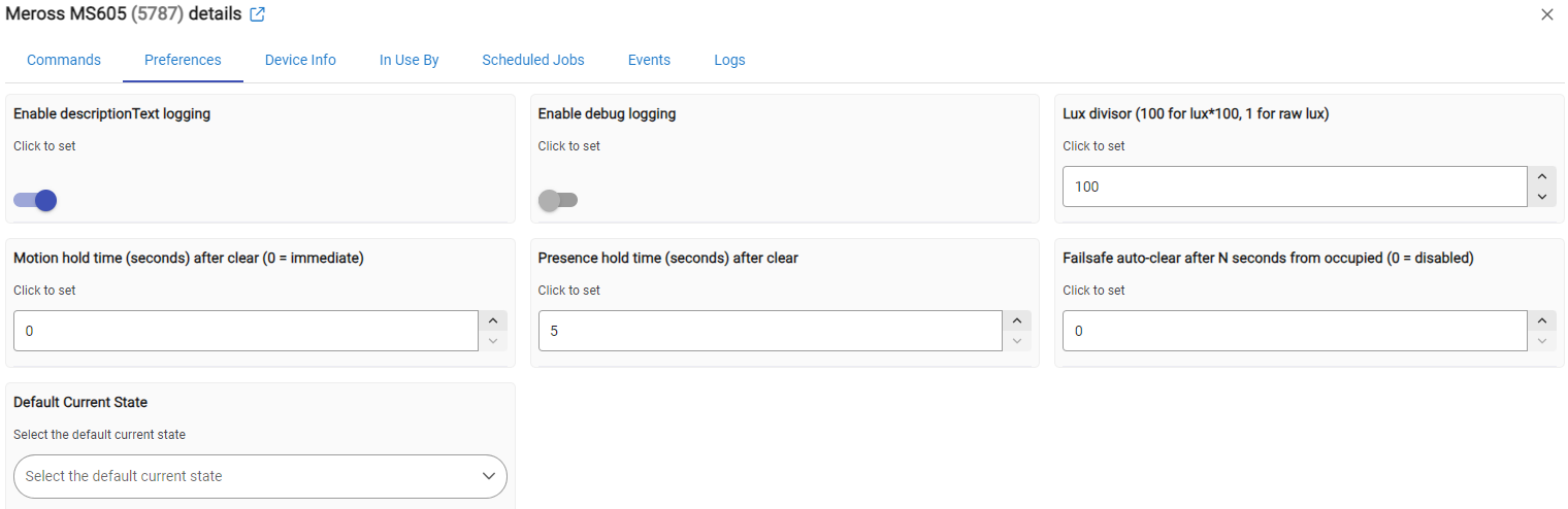

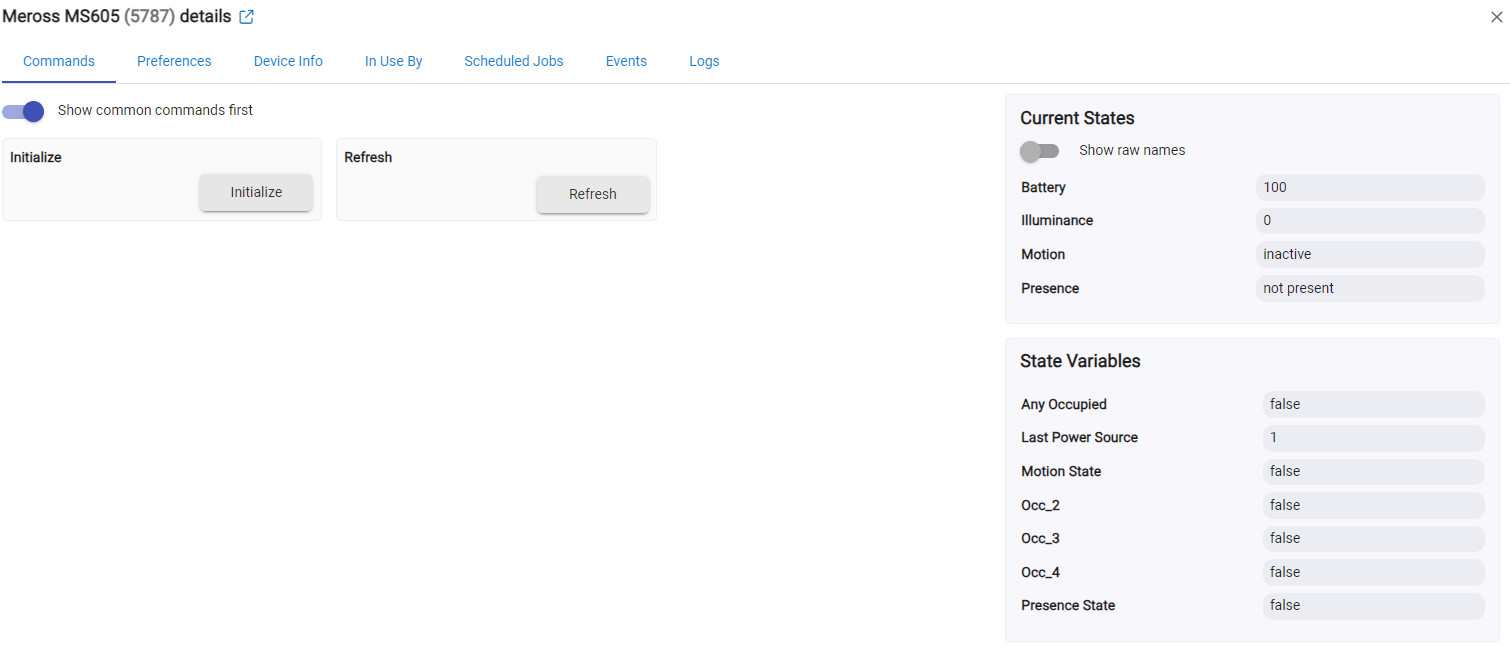

@vitaliy_kh - Why don't you try asking ChatGPT to generate a simple driver for the MS605MAT? You can provide ChatGPT with the device fingerprints and, optionally, a link to a sample motion driver as an example (like this one made for the IKEA motion sensor). ChatGPT should be able to create a working driver within seconds! :slight_smile:
Update: I created a WiKi post below - a placeholder for the code ..
Placeholder for ChatGPT driver - a WiKi post that can be edited by anyone.
ChatGPT code

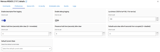

    preferences {
        input name: "txtEnable", type: "bool", title: "Enable descriptionText logging", defaultValue: true
        input name: "logEnable", type: "bool", title: "Enable debug logging", defaultValue: false
        input name: "luxDivisor", type: "number",
                title: "Lux divisor (100 for lux*100, 1 for raw lux)",
                defaultValue: 100, range: "1..1000"
        // Requested tighter ranges:
        input name: "motionHoldSeconds", type: "number",
                title: "Motion hold time (seconds) after clear (0 = immediate)",
                defaultValue: 10, range: "0..120"
        input name: "presenceHoldSeconds", type: "number",
                title: "Presence hold time (seconds) after clear",
                defaultValue: 30, range: "5..120"
        // Optional failsafe for devices that never send inactive
        input name: "autoClearSeconds", type: "number",
                title: "Failsafe auto-clear after N seconds from occupied (0 = disabled)",
                defaultValue: 0, range: "0..3600"

Thanks for the feedback @kkossev.
I recently received the MS605 and it is very promising.
Not played with it much, I have placed it in the shower, and so far it has been great (tested with Aqara M3 hub automations).
I could not get the Matter Advanced Bridge driver to work properly due to the timeout issues that you describe.
Anyway, I've had a go at ChatGPT just now, see test driver below (note: illuminance is not working).

    preferences {

Thank you for the contribution, @iEnam !
I’ve edited the wiki post and wrapped the code in “Preformatted text” block for better readability.
So, why not to tweak/fix the Matter Advanced Bridge driver? Adjusting a Timeout should be easy fix unless there is athother architectural problem on top of the Timeout. My goog guess, this Timeout affecting all Matter over Thread devices (because battery powered Matter devices definitely will use a Thread transport).
Talking about ChatGPT. My experience with this toy is not good. It usually creates non working code even with a lot of syntax errors. And than spiroling around with different errors. I.e. attempt to fix one error creates another error(s). And so on. After few ittereations it says the limit is reached, update or come back later (wait 36+ hours).
From the other side Copilot from Microsoft did created a working code near instantly. After few itterations code was polished according to my comments. And it never complained about any limits. I tryed Copilot very successfully for creating a Driver for the Shelly RGBW PM device wich has 3 different modes for LED Control and 4 inputs which could be Digital or Analog. Driver created by Copilot handles nicelly everything.
Finally, MS605 was comitioned by Home Assistant (this is the only one TBR I have in my setup). Since I already using HADB for bringing all HA devices to the HE. So, I don't need a Matter. I tied only because few people who have MS605 tried it to pair with HE unsuccefully. In my case first attempt failed but second was successful.
What is interesting - after pairing whith HE the divice became UNAVAILBALE in HA after few hours and now I cannot get it back on line even after rebooting HA few times. I am not sure what does it mean.
It is now a work-in-progress :
Perfect, Thank You!
Is it already ready to try or should I wait a bit?
Configuring the timeout is already done, but I’ll publish the update on Saturday since I’m also working on adding Matter button support — and that part is not easy… :frowning:
