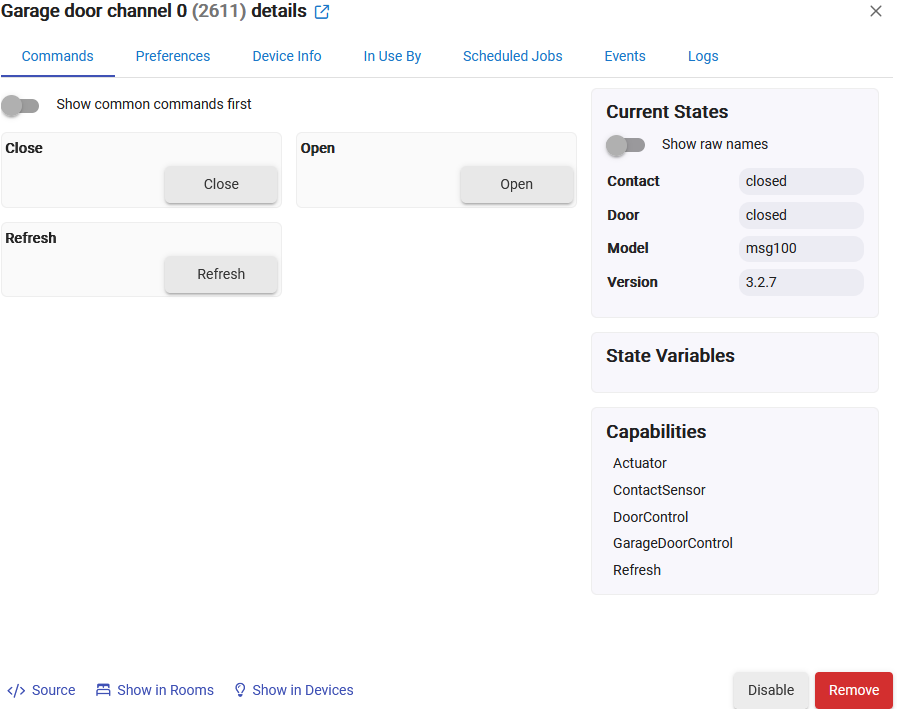

  • Added channel 0 as a valid channel during open, close, refresh and status parsing.

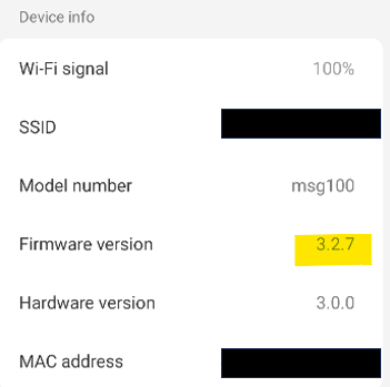

Interestingly, the driver revision for my non-homekit variant of the MSG100 is 8.1.2, way different than yours. Also, Dan’s original driver sees the MSG100, as well, I just don’t have the UUID for it to be used. The devices don’t show using his script.

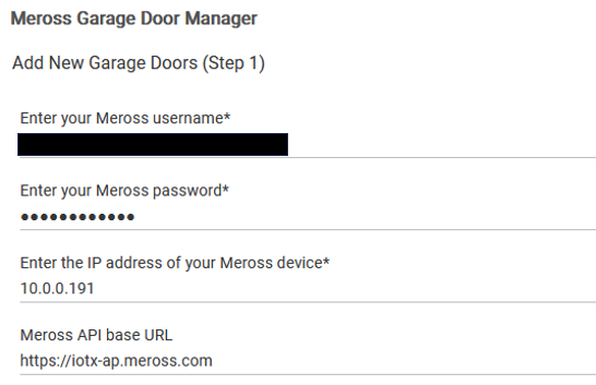

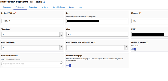

This version only needs your Meross username (email), password and the device IP. The parent app then uses this to sign into Meross Cloud, acquires the token, calls devList to discover the Meross device UUID and then creates the child device and injects the deviceIp, uuid, key and channel, etc.
The key and UUID are then visible in the chlld device as per the below.

OK let me try this. Here’s mine, BTW. Hope that vastly different HW revision doesn’t require new or updated code.
OK, I updated to your driver and your companion app but it’s still not working. It says opening but goes right back to being closed. My MSG100 with this HW revision 8 was purchased at Amazon in the US. Maybe it’s the hardware itself? Not sure, the app pulled all the info correctly and created the new device properly.

  • Open/close control and live door/contact status now reports back to the Hubitat child device correctly with no stuck "opening"/"closing" states.
