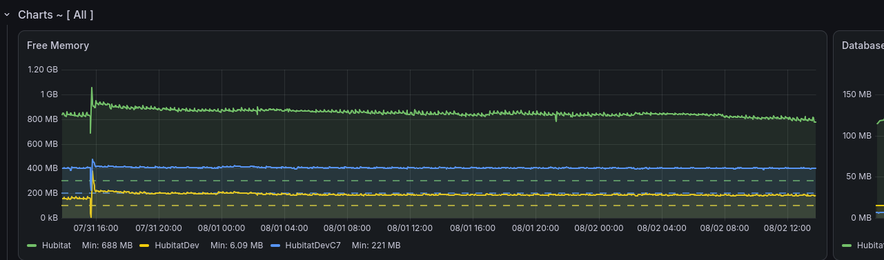

How are you monitoring the Memory. Are you using something like Influxdb and Grafana dashboards like this:
Or something else. I know some folks just look at the output from URL that give the data as well.

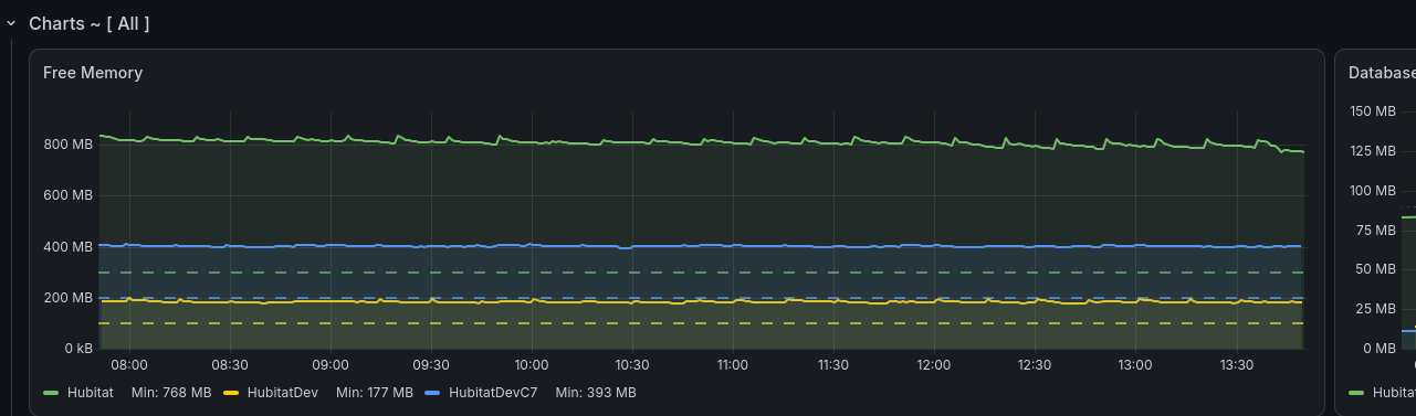

This is a more zoomed in look of it down to a 6 hour window
The saw tooth visual you can see above is what you are looking for. That would indicate the GC is working and recovering memory. That doesn't prevent tasks from grabbing allot of memory. That can be hard to see if you don't collect frequently enough though and that itself can be system intensive in itself. If you use @thebearmay hubinfo driver you could put memory on a short interval of 20 or 30 for a period of time to see if you can capture anything yanking a bunch of memory. Then atleast you may be able to get a hunch as to what is grabbing it.
How long does it last before you need to reboot because of low memory. I would expect you to be in the 100 to 200mb range before the hub would make you reboot.
