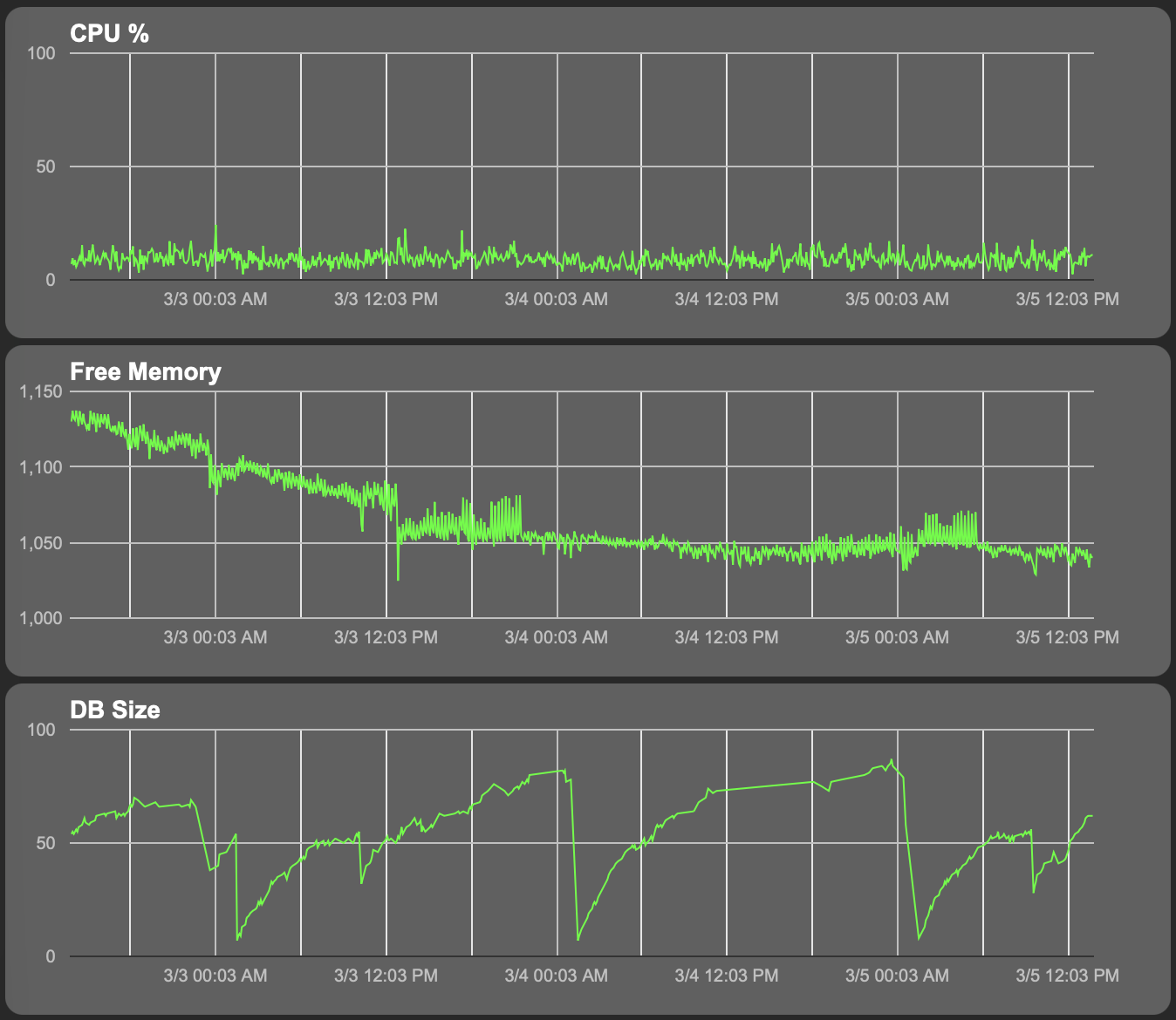

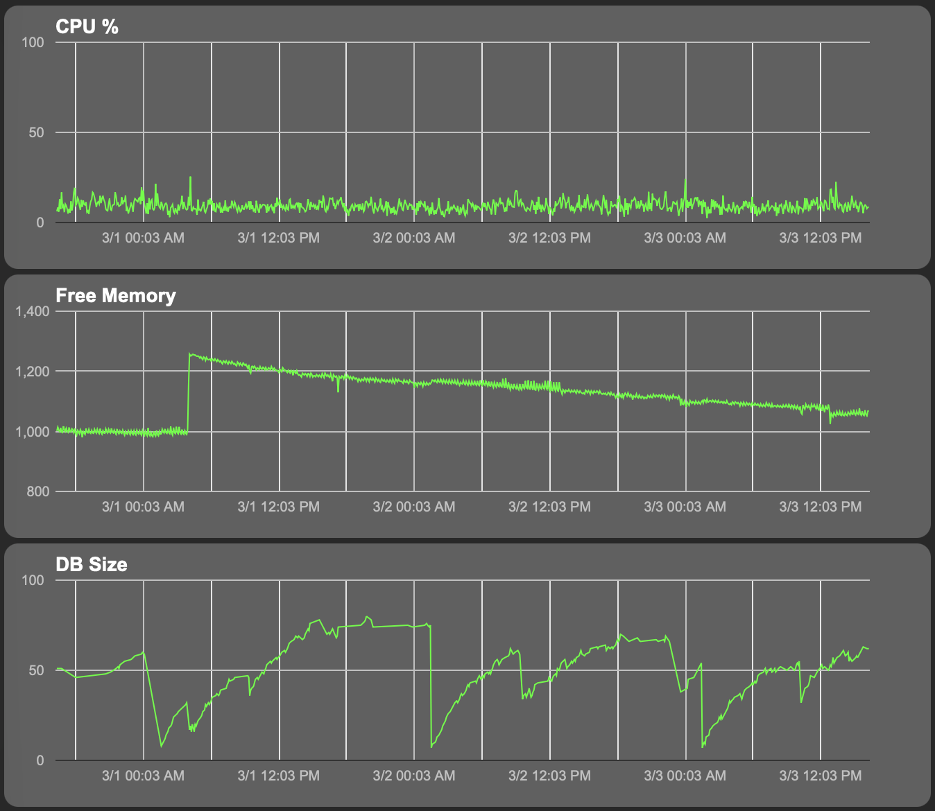

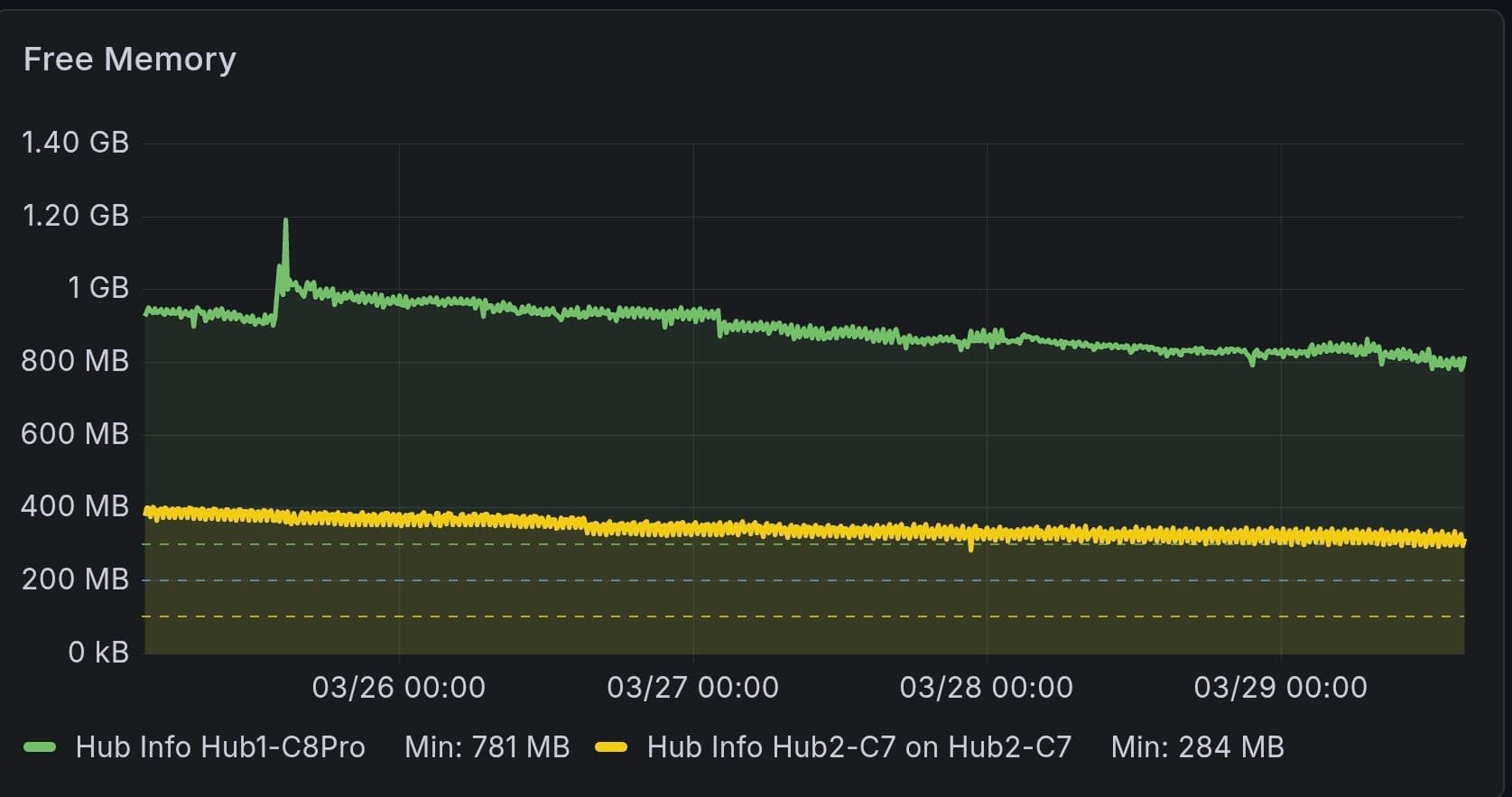

Speaking of bug fixes, the update to 2.4.4.135 does not seemed to have fixed this on my C8 Pro.
Here are some graphs over the last few days. I've still got plenty of memory apparently, and my C8 Pro is obviously not straining at all. So I'm not too worried. A reboot resets it. But it would be nice to know what's causing this. I haven't added anything new since updating to 2.4.4.135.
Any thoughts on how I might run this down? Or is a memory leak still being looked at?

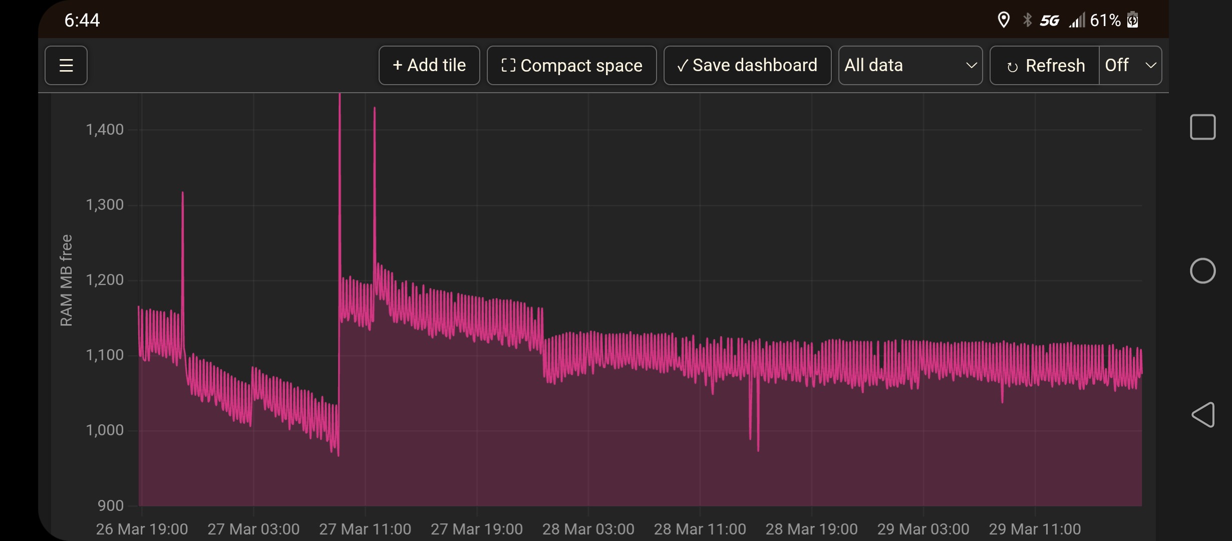

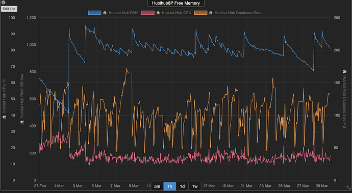

Those graphs come from Webcore. It has a graphing module that's pretty easy to set up and configure. Doesn't require any coding. Webcore is a built-in app.
I've also used Watchtower and it makes nice graphs.
Either Webcore or Watchtower will work great depending on your use case. I think Watchtowerl makes prettier graphs. But Webcore is more configurable and it's possible to graph more attributes. It just depends on what you want.

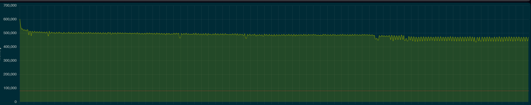

Well... interestingly enough, after dropping for three days straight free memory seems to have stabilized.
