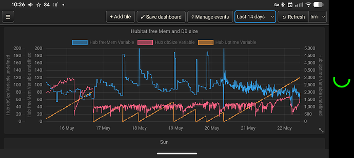

When I saw that things stull worked ok at lower Free Memory levels, I set the triggers to 40MB for immediate reboot and 50MB for my nightly reboot check. Then I updated to the latest release (2.5.0.143) and it went for a full day without rebooting. The Free Menory is extraodinarily low based on previous history, but doesn't go down as rapidly as on 2.4. Here is a 14 day Watchtower chart of freeMem, dbSize and uptime in minutes. This shows the big difference between 2.4 and 2.5.0

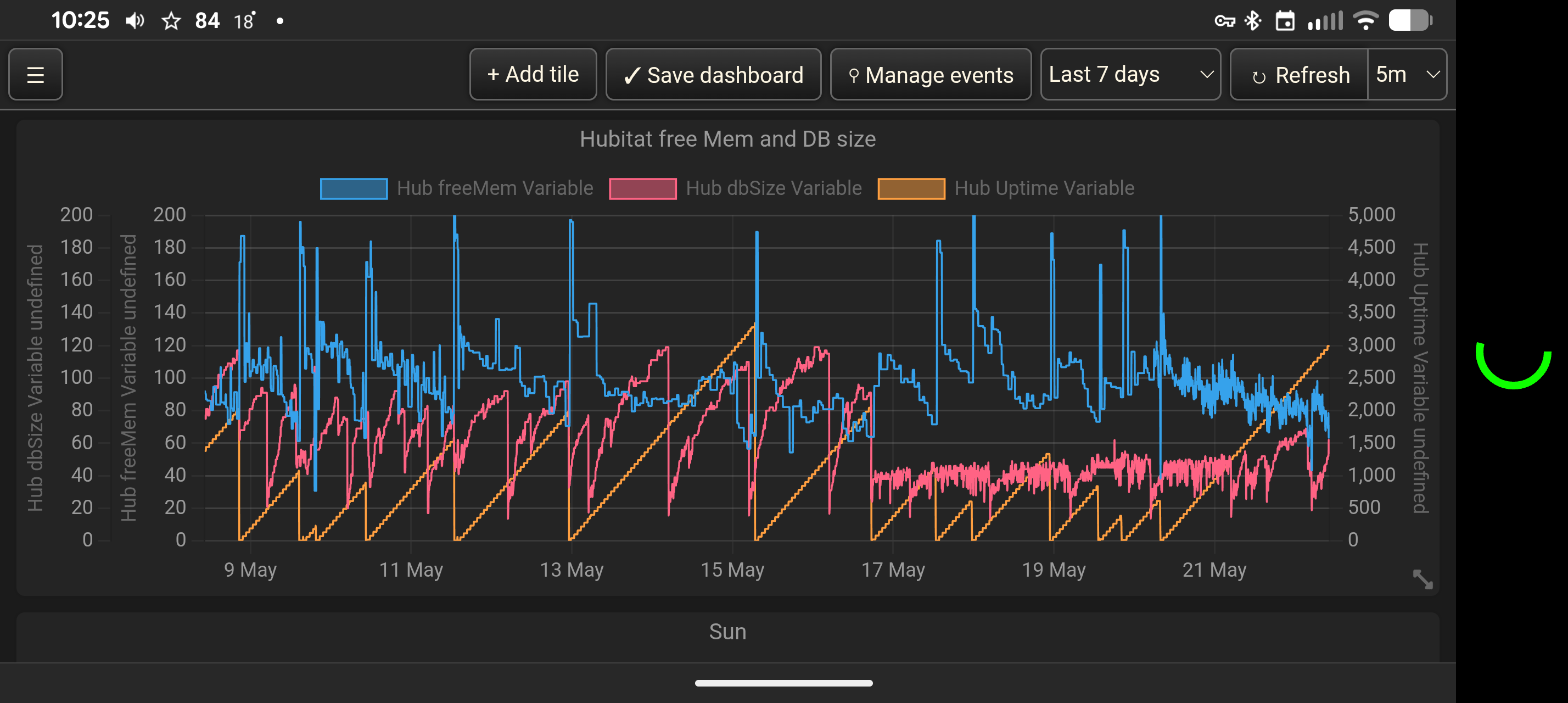

Thus next chart is for 7 days to see how FreeMem went down in 2.5.0.136 (installed 5/16 5:30pm) and then stabilized in 2.5.0.143 (installed 5/20 7:51am)

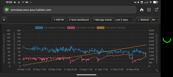

Finally let 2.5.0.143 run without a reboot and after the first nightly system cleanup routine it seems to be running well with very snappy response to various triggers. This last chart is for 2 days. It shows the nightly cleanup and several system cleanups in between.
I'm going to let it run to see what happens after a week. May be able to remove the database rebuild reboot rule that runs it after 7 days or at least extend the time.
Fingers crossed that the snappiness stays there.
