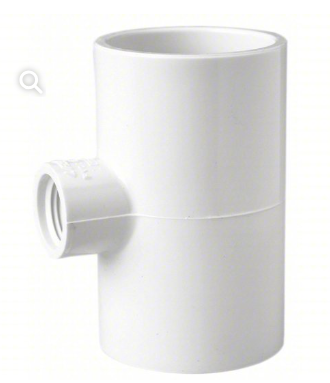

My pool pipes are 2". I got a T with a 1/2" reduction:
Screenshot 2025-10-14 at 4.15.49 PM

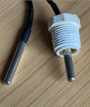

I then bought a 1/2 Plug and drilled a hole, inserted the DS18B20 and epoxy.
Screenshot 2025-10-14 at 4.24.24 PM
I made multiple to insert before and after the heater and pump. I fed them all into a rPi, but for a single, the Shelly might be the right way. :smiley:

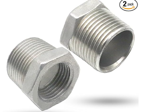

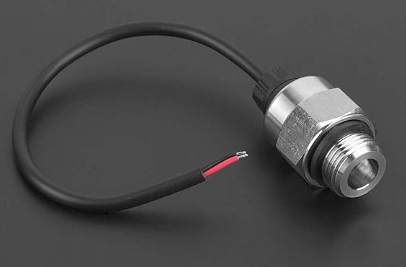

Last week, I bought a pressure sensor and it's 3/8" and I could not find the PVC T I used previously . 2" with a 3/4 reduction was plentiful and so I got one and a 3/4 to 3/8 stainless reduction.
Screenshot 2025-10-14 at 4.29.00 PM
Screenshot 2025-10-14 at 4.30.01 PM
