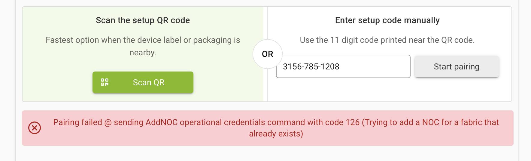

paired with Apple Home, working fine. opened to "intermediate" pairing with HE, fails every time.
direct pairing attempts with pairing code on device, fails every time. I think the failure code may change, but failure is always the result.

it is indeed MoT and it is paired and working with Apple Home a TBR; which I now take it the HE is not. the failure you see in the image contains the Apple Home proferred pairing code and not the devices original pairing code.
the device is paired and working happily with Home. it won't pair with the HE through Apple Home. as far as I can see that makes it a HE problem, not a device problem.

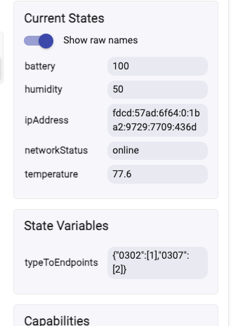

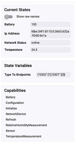

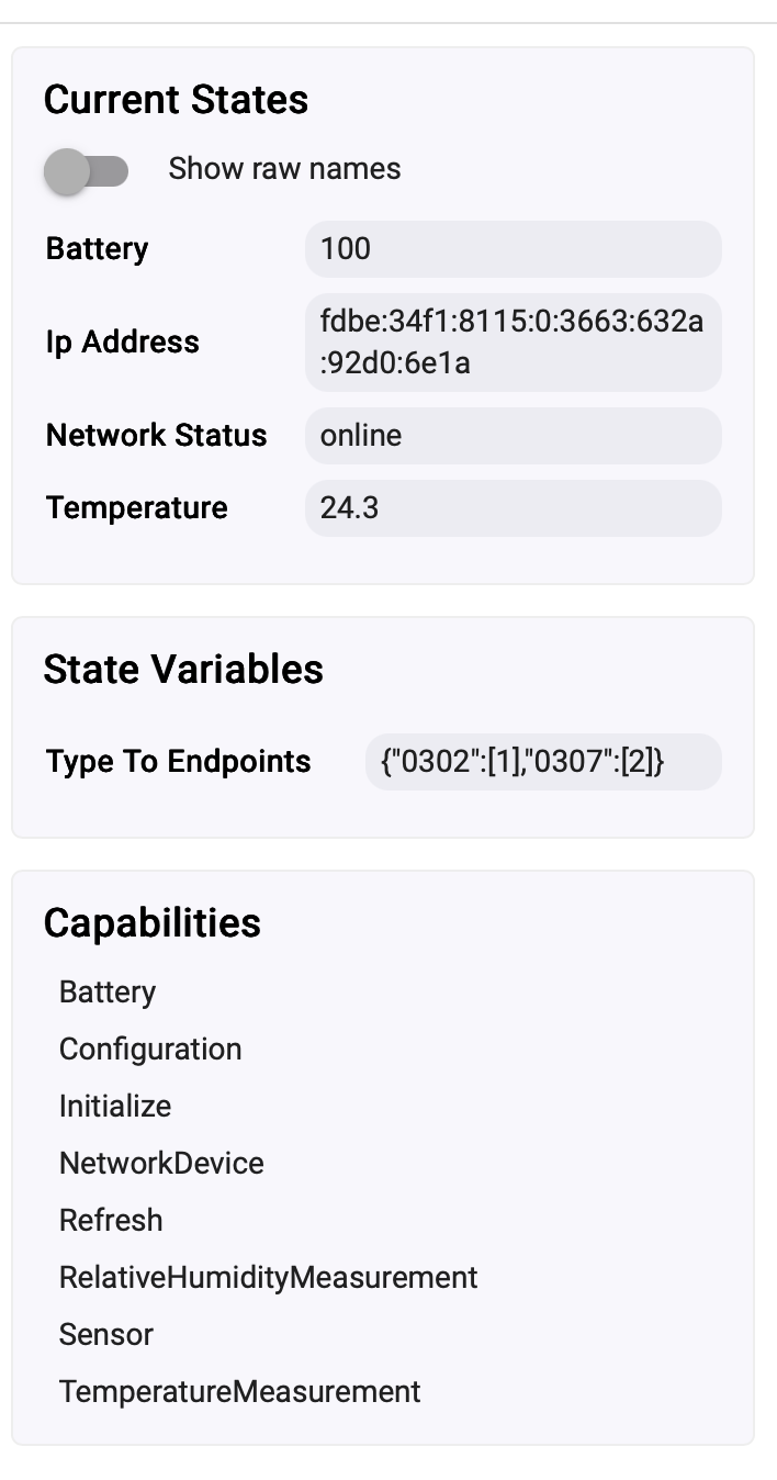

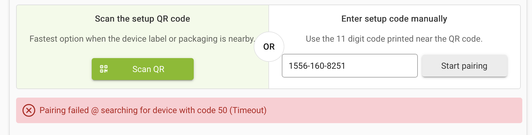

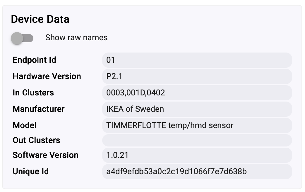

I now have a Timmerflotte paired, but only the temperature and the battery..? Why? It's identified it as a 'Generic Matter Temperature/Humidity Sensor', but it only sees 2 end points and not 3. So I tried to pair the Humidity from the sensor and it won't pair again, because... it's paired. So I tried another sensor and that won't pair with this error:
Note listed capabilities and the recognised clusters.

the first pairing is now showing humidity; but the first pairing is still aligned to the second 'failed' pairing. so instead of the 'kitchen' connected, it's the 'porch'. I'm ok with that, I know which device it is and it's updating regularly on both temperature and humidity. I've added two more devices, 'configuring' each and waiting before adding the next. everything seems ok, with the exception of the first pairing (the kitchen). this one is going to have to be reset and re added to Home as it is unresponsive to further pairing.
