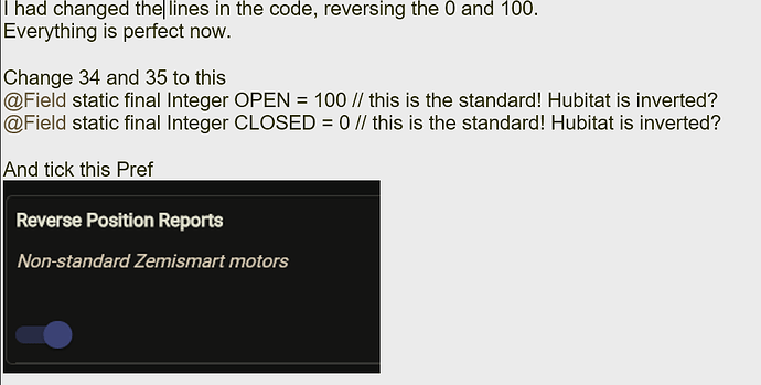

Just a quick update for those using these blinds and want the Dashboard to display correctly; mine doesn't
There was an update pushed and that's great, thanks!
It did stop my Dashboard tiles from displaying correctly again.
Here's the simple fix if you get this.
OK. I will make the same change in the next update...
The changes are included in the new MAB package update version 1.5.5 '2026/01/10 11:21 PM'
I have not yet pushed the update via HPM; please perform a 'Repair' to update all components. On a C-7 hub, the repair takes about four minutes.
Please let me know if the Switchbot Blinds are working OK.
