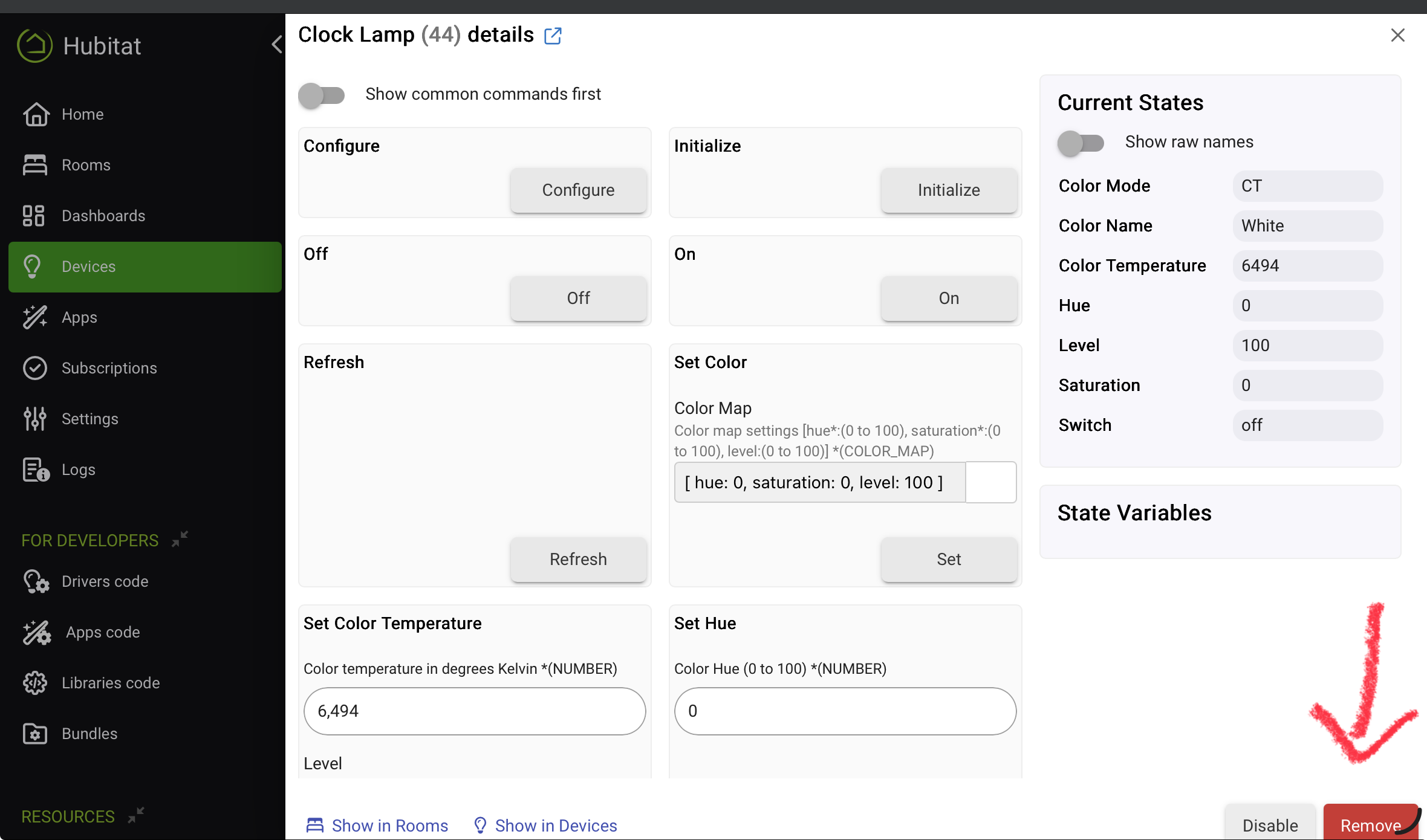

But how do I remove one of them
But will I still be able to install more matter devices if I get rid of the wifi internal ip
As long as the hub has an active connection to the router it can use the router to create a connection to any device on the same network.
Until I clicked that something created the wifi ip the matter devices would not connect to the C8
Have you read this:
I have just been trying something, do not use on one on the wifi instance and it does not disable it on the other instance, is that sufficient if I do to everything on the wifi instance?
Forget the above, it does disable it
