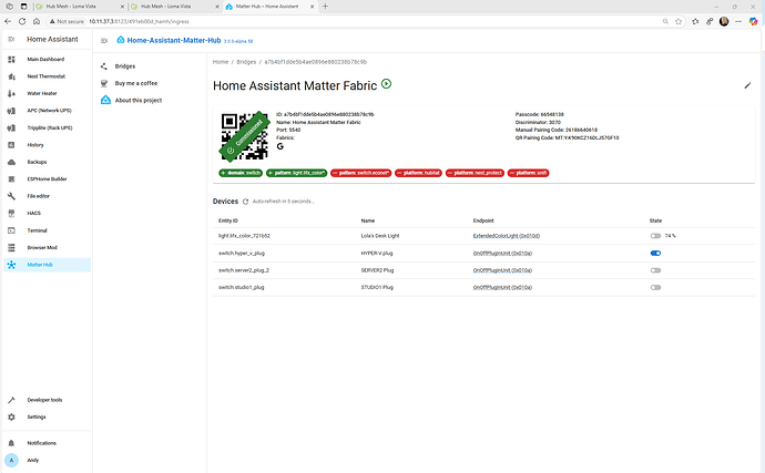

How does the "Matter Bridge" driver get installed? For the life of me, I can't get my Home Assistant Matter Hub to finish setup on Hubitat. It will not commission the device in Hubitat at all (it's an entirely software device, so no Bluetooth necessary on a mobile device), and while it commissions perfectly fine on Google or Alexa, and the sharing code won't work with Hubitat either. It's like Hubitat just has no idea what to do when trying to add the bridge.

The "Matter bridge" is currently installed from Hubitat Package Manager (HPM). It's called Matter Advanced Bridge. It allows you to add Matter devices from other hubs. Those hub's may convert their 'non Matter devices' to Matter. They often do not convert.
I don't see a "Home Assistant Matter Hub" in my Home Assistant install - I do have a HA Matter Server though and It can share matter devices with other hubs.
It is a rework of the older "Matter Bridge" add-on for Home Assistant. It is currently in "alpha" stage, although it seems to work beautifully with both Google Home and Alexa. It basically allows me to take any device or entity from HA with a matter-compatible component to it and share it as a matter device to any other ecosystem that supports Matter. Except Hubitat apparently. It's the only system so far that flat out refuses to commission it or accept it as a shared device from Google's Matter network...

That being said, I have yet to be able to add the Arduino "Nano Matter" device to Hubitat. It is a Matter over Thread device, which presents itself as a Matter Bridge. I have it paired with Apple Home. However, when I try to share it from Apple Home to Hubitat, it is never successfully added to the HE hub. Sounds similar to what @a.mcdear is experiencing trying to add HA's Matter Bridge device to Hubitat.
Yup. I have an ESP32C6 running a Swift dimmer example that works with Homekit and Home Assistant but not Hubitat. I could attach a terminal for logging and look at the Swift and C++ code to see where the problem might be but that would require effort and thought. I can't blame Hubitat until I've at least looked at the code. Maybe it's alpha quality. ![]()

Yes, at the moment it is quite finicky. Before you have a chance to configure it, it attempts load EVERY entity from HA into it, and when there's something that it can't figure out how to make a matter compliant device for, it crashes hard. I had to write a config file to force it to ignore all entities at first and only try to include a select few that I knew would work, like a switch or a bulb. Once I got it running, I was able to use it's own tools to include/exclude the items I wanted.
I'm sure there will be a GUI for all that eventually, but for now you have to set it up pretty manually.
