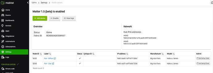

Matter 1.5 (beta) is enabled
Overview
Status: Online
Fabric ID: BCAEB2A2ECEB93E7
Network
Hub IPv6 addresses
wlan0
fdb6:b7a8:520b:1a7b:aed9:29ff:fe09:b440
wlan0
fe80:0:0:0:aed9:29ff:fe09:b440
one fan joined and that was just random after deleting and readding a few times.
