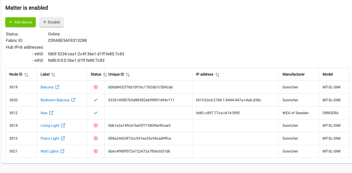

Since the last couple of updates, possibly since update 2.4.3.155, homekit matter devices are unresponsive. Plus I am unable to add matter devices once removed.
For some reason two devices still show as active and can be controlled via hubitat. All other lights work via homekit, but not through Hubitat.

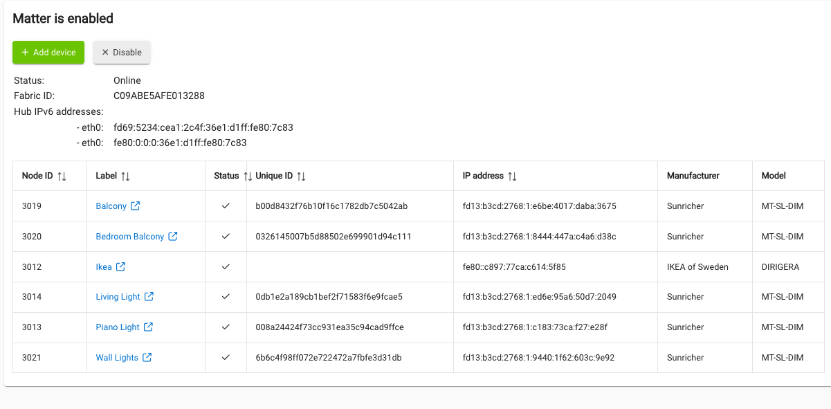

One observation from the matter details page is that the devices working show an IPv6 ip address, while others that are not working are showing blank for the IP.
Disabling and reenabling matter on Hubitat momentarily and falsely shows ticks in the status column against all matter devices. Refreshing the browser, reverts back the status to as shown in the screenshot. Rebooting all homepods used for homekit makes no difference. All automations for unresponsive devices show failure to control from 11 Nov onwards. C7 is always kept upgraded to the latest version as soon as they are available. So, I am wondering if anyone else has seen this issue and if it is related to any recent updates released.

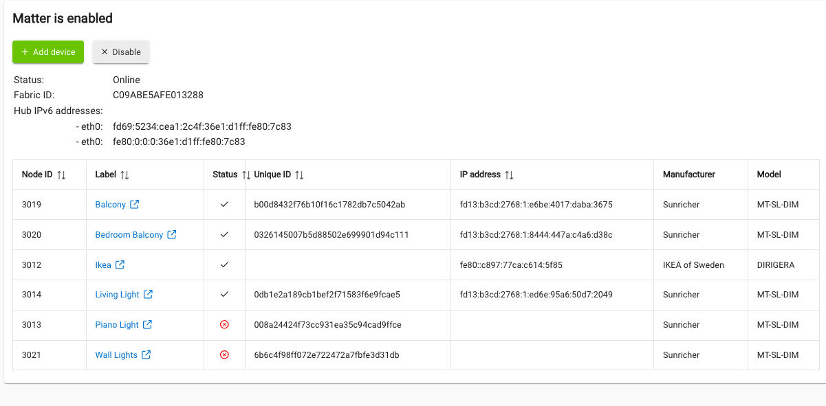

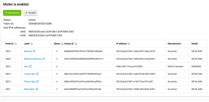

As suggested, I removed power for the devices by switching off all my lights at the distribution board and turning them back on after 30 seconds.
The result was as per the image below with all devices showing as active and ip addresses filled in:

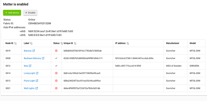

That said, when I tried to control the lights, there was still no response and matter details showed crosses against the two lights I tried as per the image below:
I then rebooted the hub and left for work.
I have now tried it and everything seems to be working as expected. So somewhere between powercycling the device and rebooting hubitat, the issue seems to have fixed itself.
