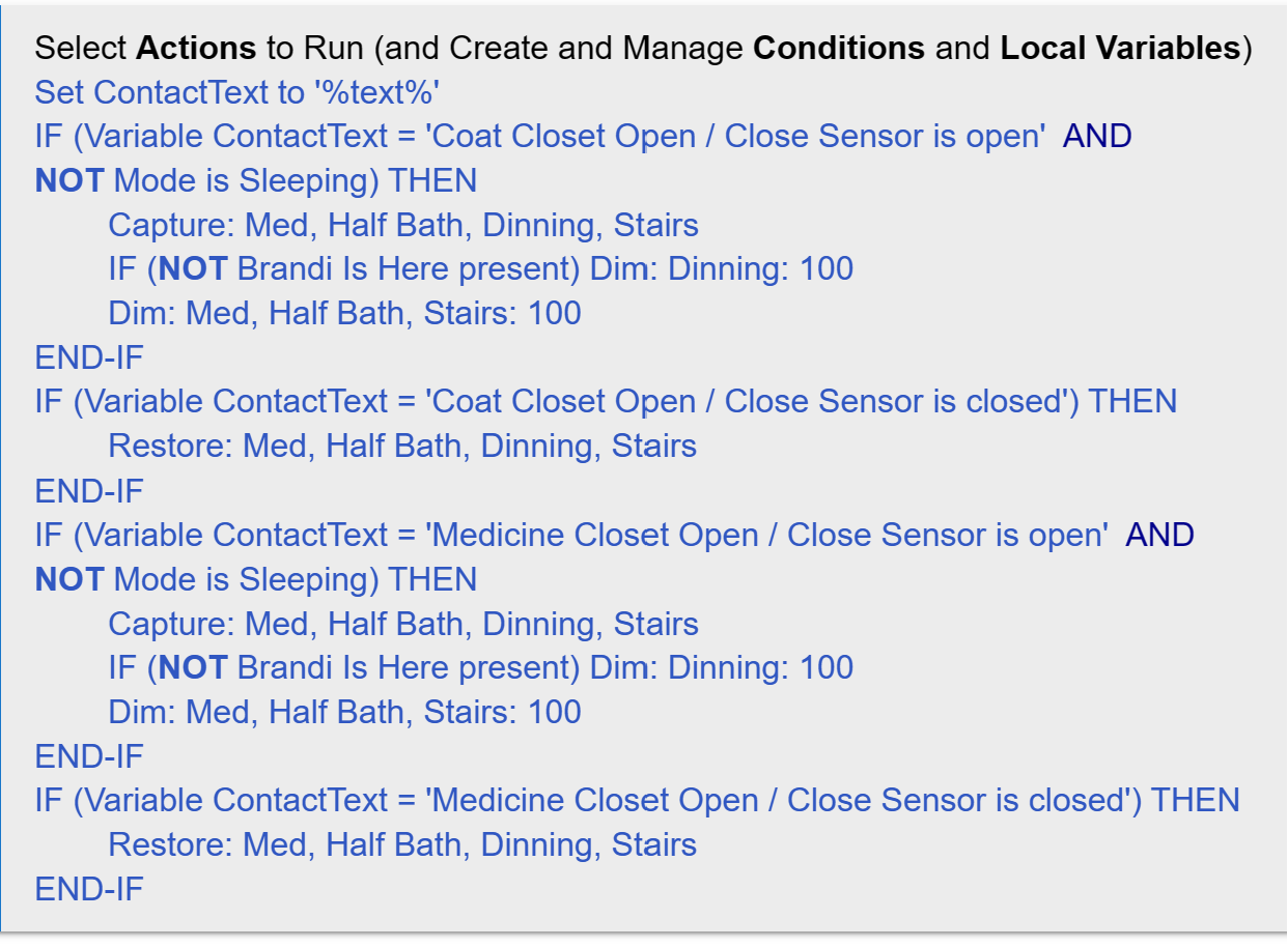

This time in IF statements in a single rule that match the state of multiple open / close sensors.
Trying to think of a reason why to use the %text% instead of just the device state? Cannot think of a reason. Ultimately the device state would be most future proof from having to be tweaked later.
Post a screenshot of the rule if you don't mind.
Thanks…I will in a bit …but it boiled down to if the other sensor was closed it would trip those IF statements…so just be open or closed doesn’t matter in the rule.
Completely open to other approaches
Post a screenshot of the rule. Usually %text% is useful only for “events” that aren’t in the event log. Like locks being locked from the inside (or by key) vs via a button push.
Wont this achieve the same thing? Just check the device state instead of the %text%.
I guess the only thing it might not catch is which device triggered it... I think that can be fixed.

Not if either contact is closed in the same rule.
I think this would do the same thing as yours, just without worrying about the exact description text, and also eliminating duplicated if blocks.
Possibly may need to make the ELSE-IF a separate IF block like how you have it, depending on what you want it to do exactly.
Thanks…I’ll give it a shot in morning. I hope to have a single rule to manage all 7 sensors. 7 rules would be easy.

Right…just if the rule was triggered by a change in any of them…since anything other than the first IF statement is always true (closed) it triggered the IF statement matching their closed status and instantly turned off the lights.
That's why I changed it to save the trigger value and then check that. That %value% variable is the value that triggered the rule. Very similar to what you were doing with %text% but much less susceptible to change. The only way it would get into the "close" block is if the device that triggered the rule changed to closed.
Awesome…thanks!
