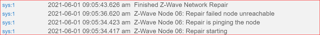

First of all, just 7 minutes ago:

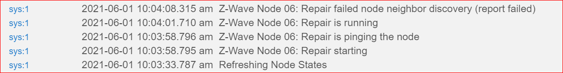

Then with no changes, 7 minutes later:

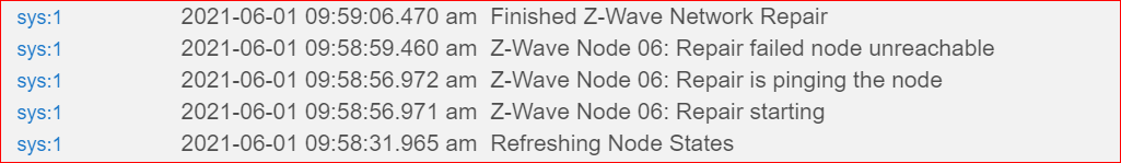

This was a single node repair.

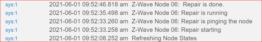

And finally, a different message:
Guessing here, but it looks like the device is currently at the edge of the mesh (due to physical placement or the failure of other nodes on the mesh) and is losing connection to the hub. May want to ask @bcopeland his opinion though.
