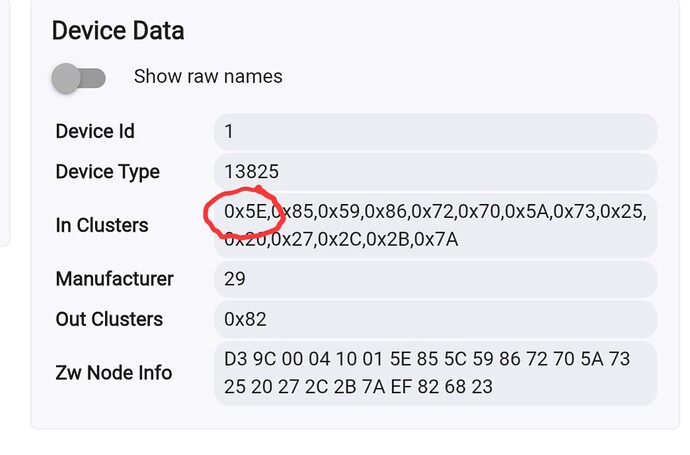

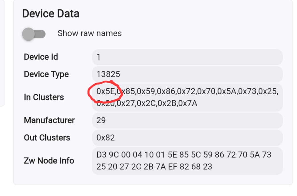

Or, on the "Device Info" on the devices page for the switch, look for 0x5E in the "Device Details" section.
If your switch is not Z-Wave Plus, you will need to run a polling app or create a simple rule to periodically send a refresh command to the device.
