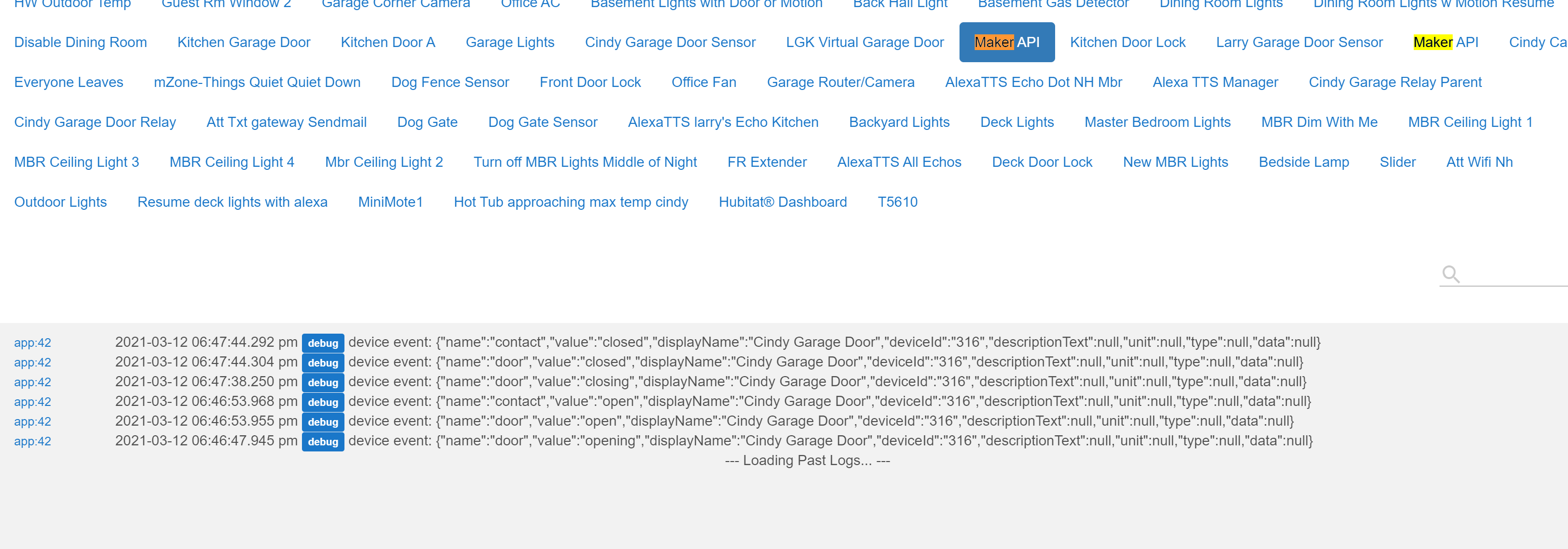

weird .. here is the url attempting to be called in the old logs, after i tried to ermove it multiple times..
obviously i dont want to try again as it took me over an hour to reconfigure the widget on my garmin watch with the new urls..
maybe the url is not being called. but i definately saw the logs show the url on save of the app even after removing.. can you see that.. maybe as you say the subscription is gone and its just some latent info hanging around.
Just look at the App Status page.
OK, this is not a bug, but rather a user mistake of some sort.
No, this doesn't happen for this app, or for any setting that is removed....
