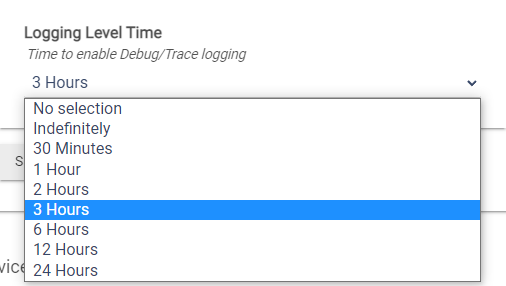

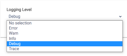

I have wanted to get away from the two "standard" toggles for a while. Partly because I use the trace logging for debugging a lot but previously I had it as a commented out line in the code. Its easier to turn on from the UI per device. Also I wanted to let people pick the auto-off time. I started working on my own driver library for my common stuff and I came up with this for logging. Got rid of the other toggle and added two new settings.
What do you all think?
My other thought was to just have one setting with the permanent log level and then have a command button to set a temporary elevated level if needed but the command button was ugly and bothering me.
What if I, as a user, wanted to log both Error AND Debug, for example? Is there a way to set two or more log levels at the same time, or is it just one at a time?
I'm going to guess that the selection includes any "lower" log levels.
E.g., selecting info would also include warn and error.
That seems smart! Would there ever be a use-case where I would want just TRACE information; but it might be difficult to "follow" because of the other log levels cluttering the log file?
Yes as @anon47916022 said it would log anything from the level you set and lower. The way I do my logging Info > Debug > Trace all compliment each other so it is good to have them all on if you need the most logging. Error and Warn are used for exactly that, errors or critical warnings.
  • Info - status changes and other general info
  • Debug - events where status does not change (or forced events). Other info thats helpful for troubleshooting but you don't necessarily want to see in the logs all the time.
  • Trace - Logs info for nearly every function with the parameters sent to it. Useful for heavy programming debugging only. Used to "trace" the code as it moves through functions.
