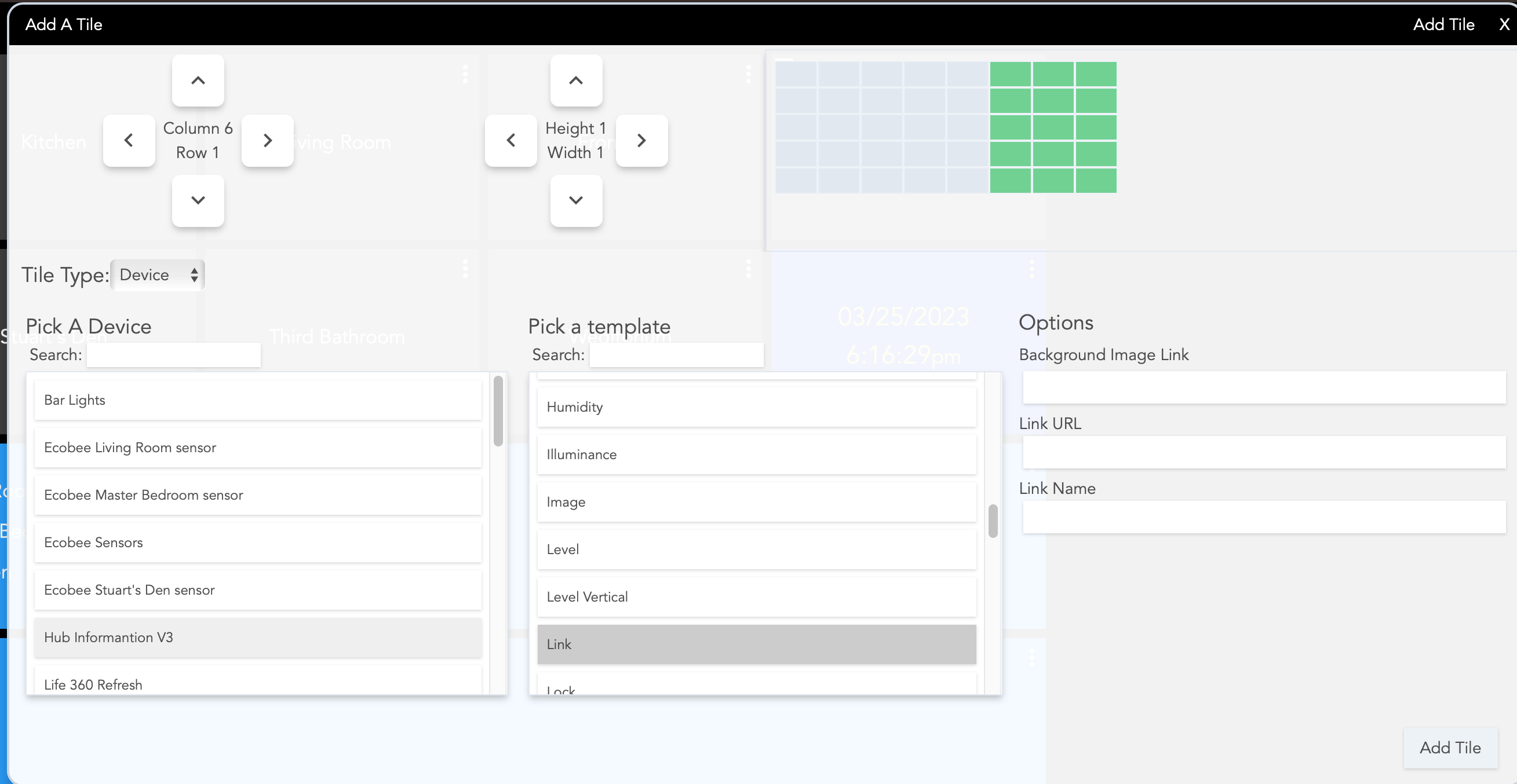

I got the Hub Info Driver V3 installed, set up a virtual device with it as the "type" and added the virtual device to a dashboard. When I went to add this virtual device to my dashboard I don't see HTML as a template. So I'm lost when you say to create a tile with the HTML attribute.

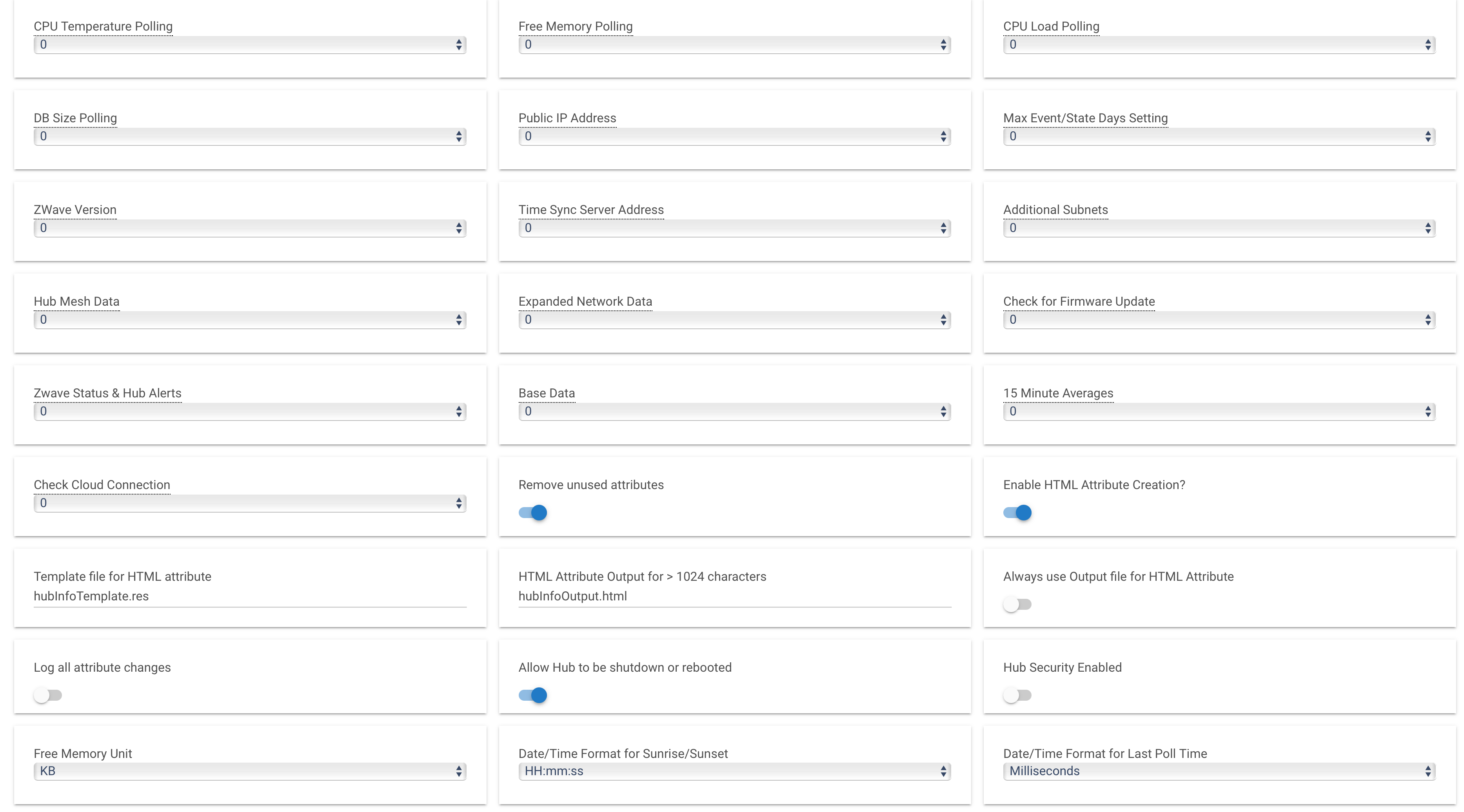

Needs to be turned on..

My layout is a little bit different than yours, but I turn it on as well as Remove unused attributes and Allow Hub to be shutdown or rebooted as I saw you had those turned on. (See screenshot below).
I then clicked Save Preferences, and after I saw the screen flash, letting me know that was done, I clicked Save Device and waited for the screen to refresh.
I then went back to my dashboard and clicked the "+" in the upper right corner to add a tile and picked the Hub Info again, but there is still no HTML template to pick.

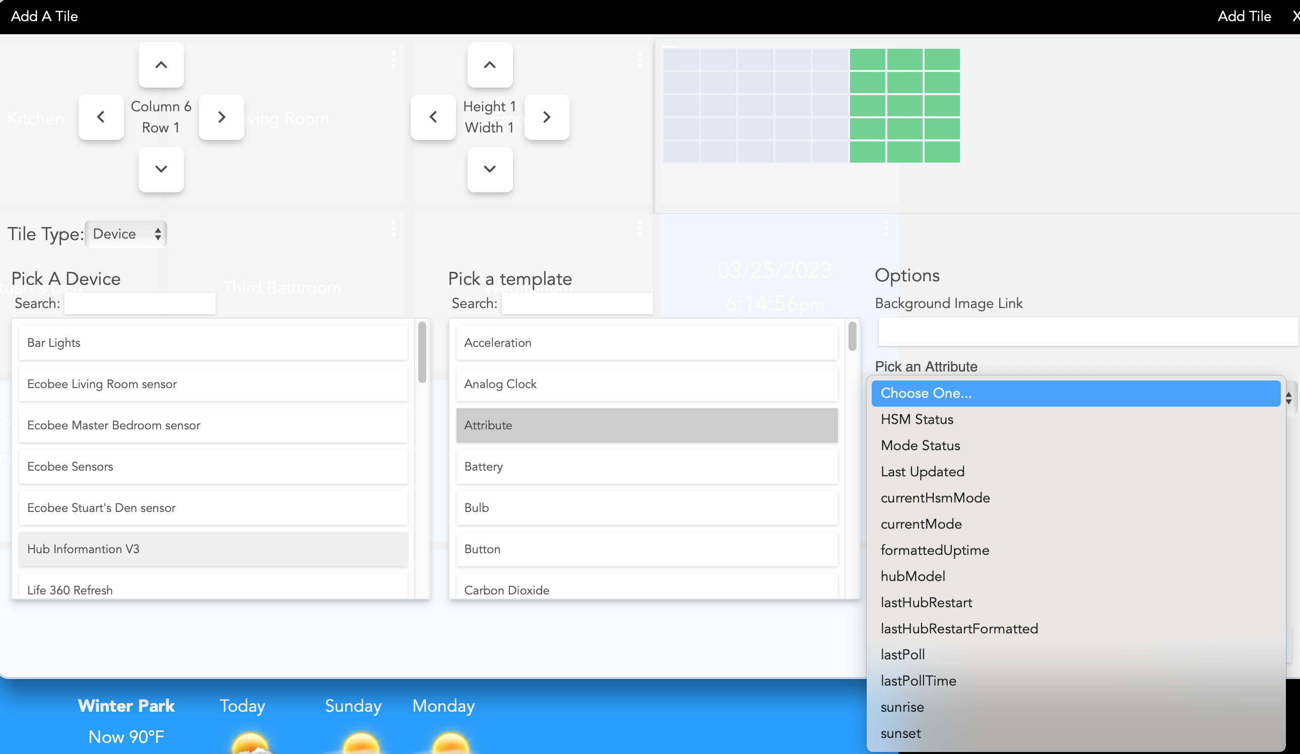

BTW, I thought it might be an attribute, but I don't see HTML listed there either:
If it is a link I'm not sure what to put in for the values:
So I'm clearly missing something, and would appreciate some more instructions on how to set this up.

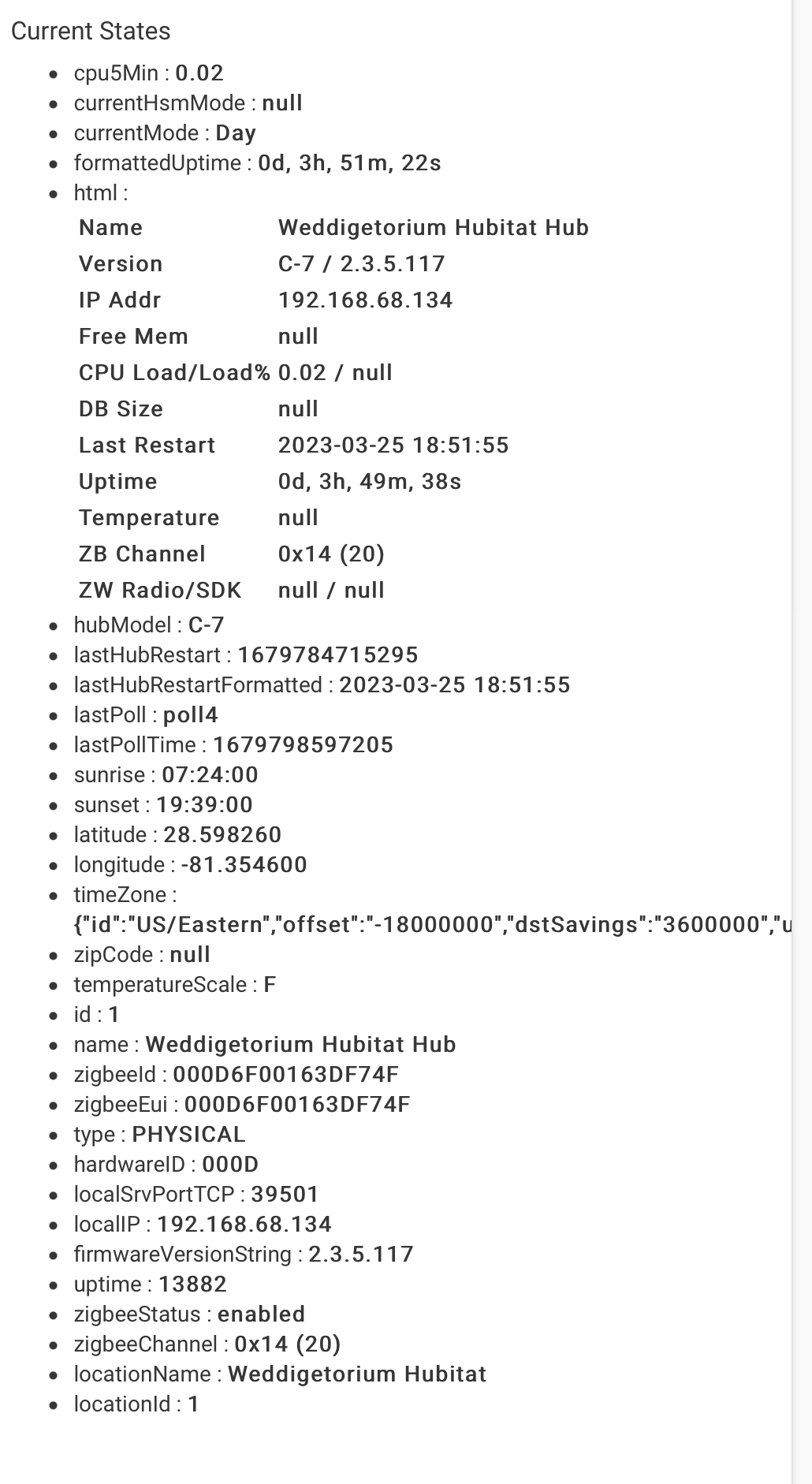

Rebooting gave me a lot more attributes. But Free Men and CPU Load (which I assume is what you suggest I monitor) is showing zeros.
It's been over 20 minutes and I refreshed the dashboard page but the values aren't updating at all.
By clicking Refresh in the device itself I got most, but not of the values to come through. For some reason Free Mem, CPU Load% and Temperature are all nulls.
From inside the device:
On my dashboard once I click refresh inside the device:
