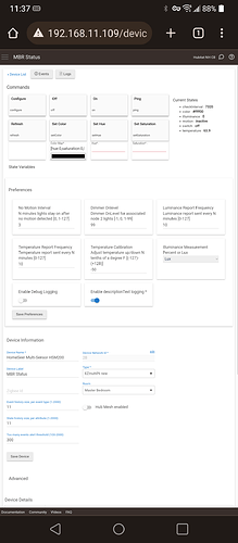

@kahn-hubitat THANK YOU!
I see your driver lets you set the interval of how long the light stays on after no motion is detected. If that works, that is terrific and exactly what I need for a night light.
One other clarification: With your driver, is it possible to simultaneously use this device as a night light AND as an indicator? In other words, is it possible to write a rule or rules that result in no matter what the lux and motions readings are, if basement door is open for >10 minutes, light goes on red and stays on until basement door closes, regardless of any other input. However, IF no other input, and lux is under x value, and sensor detects motion, then light goes on white for 3 minutes?
No . You can turn.the night light on but if yoi.also.use as a motion the night light will turn off at end of motion. But you can write a rule to override.
Trigger switch off
Required time between x and y
Action switch.on
