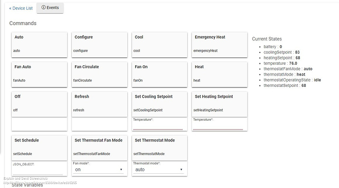

I recently purchased a Lux KONOz thermostat and I can't get it to work with Hubitat. I can get it to initially connect to my hub but after it is connected I can not send or receive any changed values.
Things I have tried to get this thermostat working
  1. Repair the thermostat to my hub.
  2. Change the device type from 'Lux Zigbee Thermostat' to 'Generic Zigbee Thermostat'
  3. Do a factory reset of the thermostat and reconnect to my hub.
None of these have fixed my issue.
I have other Zigbee devices, Hue lights, and I have had no issue with them.
Has anybody had any success getting a Lux KONOz thermostat to work? It is listed as a supported device. Could my thermostat be defected?

I tried refresh before, Just tried configure and refresh now and the only thing it does is prints configure or refresh in the device log, nothing in the zigbee log and no updates.
