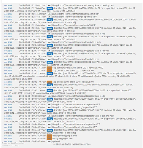

Mike, doesn't appear that the driver for the Konoz is reporting the operating state accurately?
I set the heating setpoint well above current ambient temperature.
After a few seconds, the thermostat showed "ON" (Heating Active) and the device page showed "pending heat".
After a minute or so the heat came on correctly. The thermostat still reported "ON" on the display, but the device page still showed "pending heat". I left in running a bit to see if it ever updated, but it didn't.
I took a screenshot of the logging which reflected some unhandled attributes, perhaps Lux changed something in the production units?
Edit: I also tried the "generic zigbee thermostat" driver, same results reports "pending heat' when it should report "heating"
