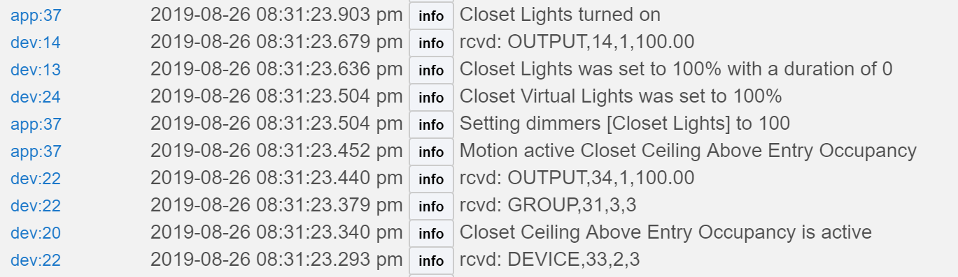

Overall, it looks like it's generally taking in the ballpark of 550ms between when the motion event is printed and the dimmer update is printed. Does that sound normal? When not including Hubitat in the logic, the time is reduced all the way down to about 150ms. One thing that concerns me is how long the Hubitat seems to be taking for local processing (rules, motion lighting app, etc.). For example, in the screenshot below, why is there 211ms between motion event received (rcvd: DEVICE,33,2,3) and STARTING to send the command to turn the lights on (Setting dimmers [Closet Lights] to 100)? I would expect that once the Hubitat received the motion event, it would be sending out the command to turn on the lights less than 10ms later, not over 200. Is there something wrong with the Lutron integration here, is the processor in the Hubitat just extremely slow, or am I missing something?
Similarly, when using Rule Machine, I have noticed that there is usually about 200ms between when Rule Machine prints triggered and when it prints the action in a (simple) if statement. An if statement shouldn't take that long to run.

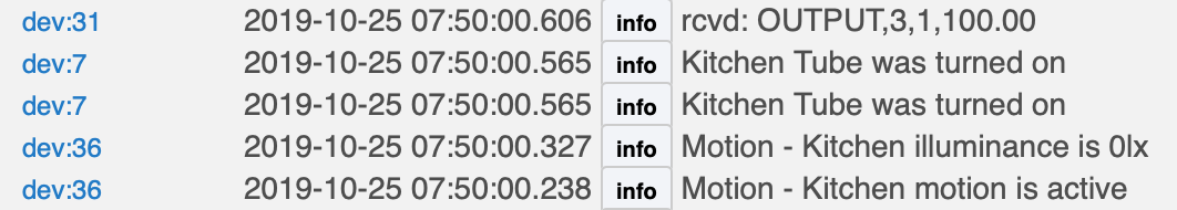

Here's a situation from my house that's comparable to yours:
Dome z-wave plus motion sensor (Kitchen Motion) being used as a trigger to turn on a Caseta Switch (Kitchen Tube):
It took just 327 msec from when Kitchen Motion reported motion to Hubitat to the Kitchen Tube being turned on.
I think that is very fast.

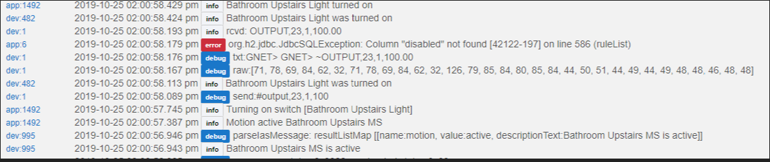

Yeah and mine is like the following.
And that error brings me to the default rule machine setup page.

Okay done, i'm not seeing that error after 10 mins of live logging.
Looks like I still have the error.
app:62019-10-25 03:05:08.090 pm errororg.h2.jdbc.JdbcSQLException: Column "disabled" not found [42122-197] on line 586 (ruleList)
OK, that's very odd. This, however, would not have anything to do with your timing issue. Were you doing something with editing or creating a rule, or global variable? At the time of this error occurring?
