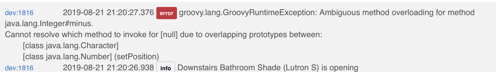

OK, how about doing the same thing after doing Set Position. Like Set Position to 50.
Tried that. No change.

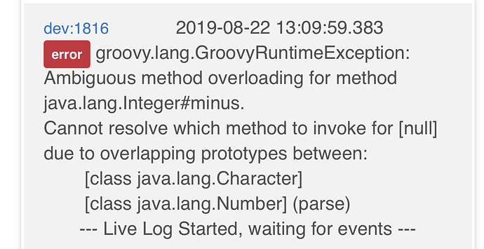

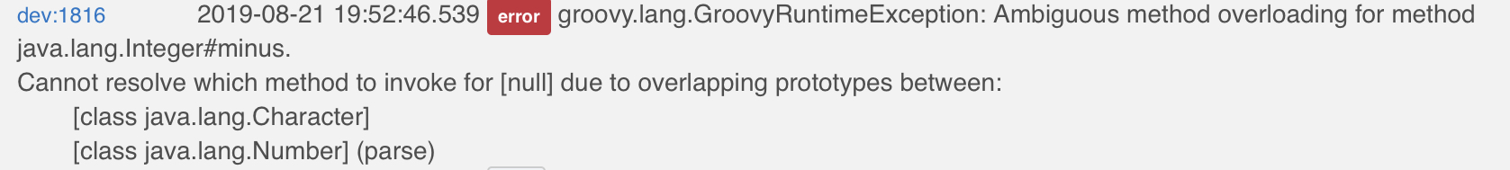

I updated to 2.1.4 and am seeing the same error with my shades. I even deleted the device and had the lutron integrator recreate it. same java error pops up in the logs.

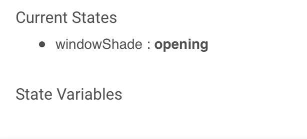

hrumph..., from the driver do a setPosition 50, then post a screen shot of the current states as well as state variables...
Not much there
Same error in the live logs after issuing that command?
Nm, you already said it was the same error.
I was able to completly duplicate the error you had and the update I made fixed it, so no idea what's going on now...

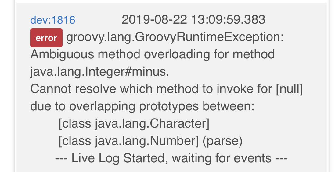

If you don't mind posting the error again, it may be slightly different then the last one.
I was interested in the results of setPosition 50

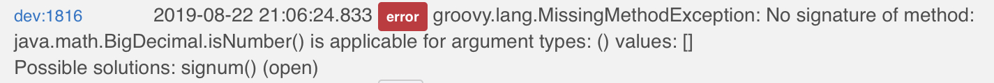

some improvement! when I press refresh, it now refreshes and doesn’t throw any errors. open, close, and set position all give errors, but it appears to be a different error.
