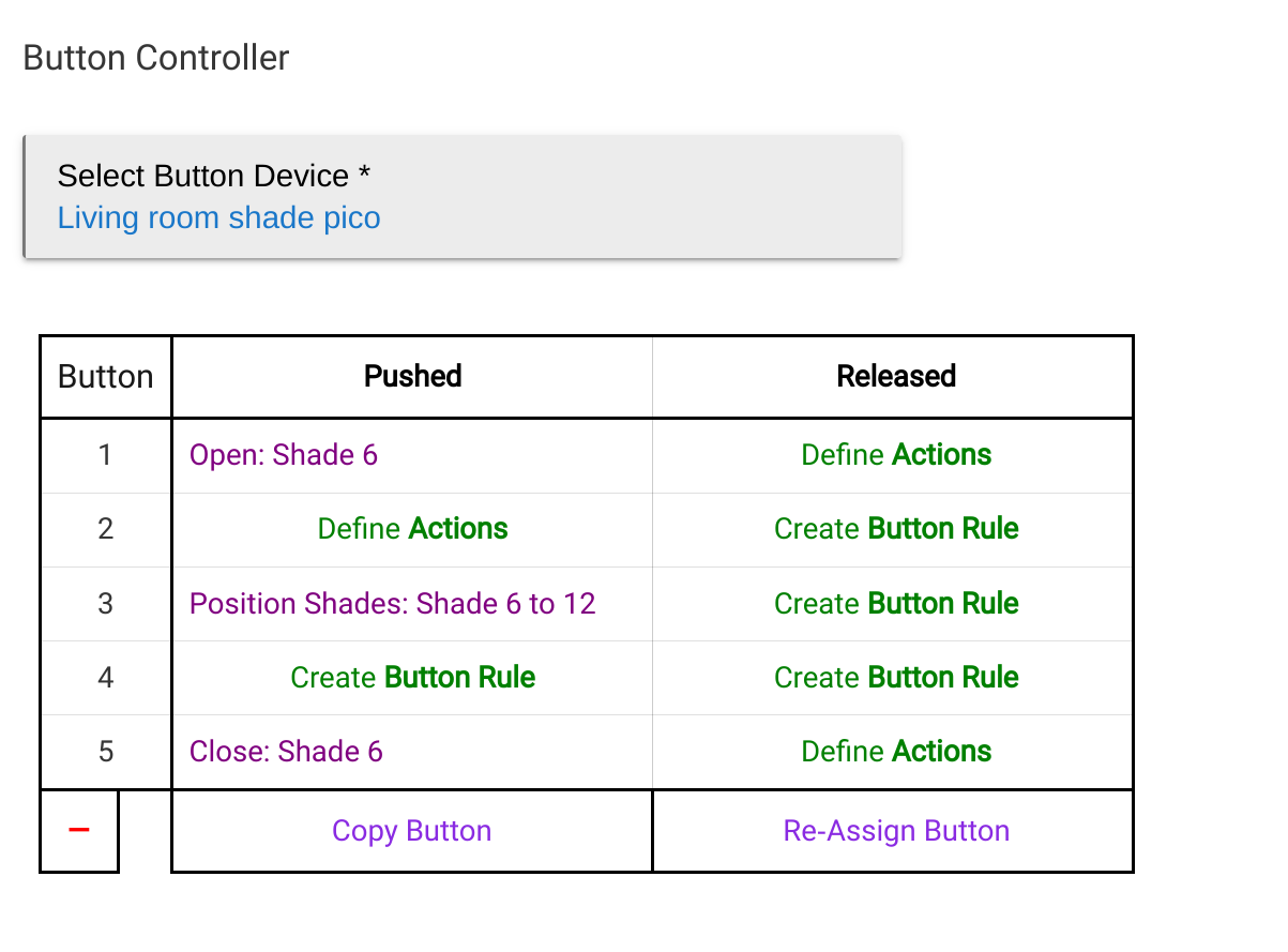

I've got a pico managing a Smartwigs shade reasonably well. It appears that "start position change (open and close) are not exposed. My current work-around, using the user driver from Package Mgr, SmartWings Motor Shades, is combining two button controller apps. Button Controllers and Dimmers Button Controller (who knew). Button Controller for 1,3, 5. Open, Set level (I'm treating this as a favorite) and Close. Dimmer Button Controller for 2, 4. Dim up and Dim down by 15 positions. This works surprisingly well with no noticeable lag. I'll b e curious as to how well it can handle multiple shade together when the arrive in another week or so.
This is the BC rule I'm using to control my SmartWings shades with the stock driver.

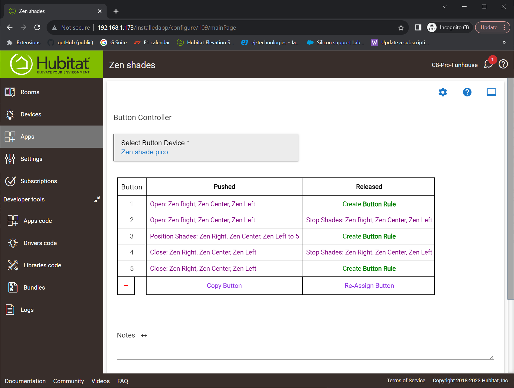

This is the basic control of what I want. But do you know of any route for us to change which blinds we can control with a button? For instance, if I only want Zen Left and Zen Right, is there a conditional I can set with a button push to change the switches control to only work on Zen Left and Zen Right? As far as I know...there's no global variable I can cycle through and set with a button press that is shared across buttons. If there is, I could set global variable = 1, 2, or 3 to control Shade 1, Shade 2, and both Shade 1 and 2 respectively. Then when global variable either = 1, 2, or 3, the other button presses will control the opening, closing of said set of shades. This is probably overly complicated for Hubitat's button controllers...
