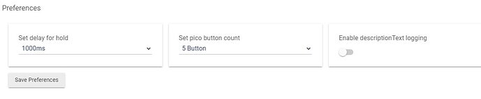

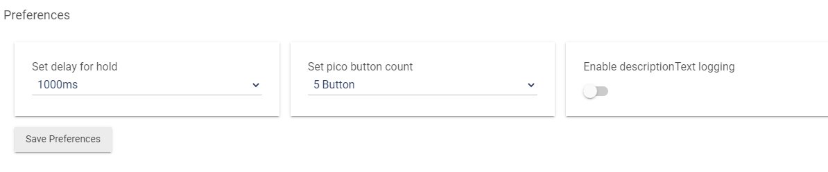

Does it make any difference whether you set this "Delay" setting differently? If I remember correctly, the Lutron hub waits until that Pico times out before accepting more button presses.
Both the bridge and the hub have reserved addresses on the router, and the ip in the integration matches, yes. The setup has been working for a year and a half and the only thing that has changed is software updates on the hub.
I am using the normal Pico driver. I don't think the delay is the issue, as even the first button press is often missed and it makes no difference if I wait 2 seconds or 10 seconds between presses. It also doesn't only happen on holds. However, I will try a shorter delay.
