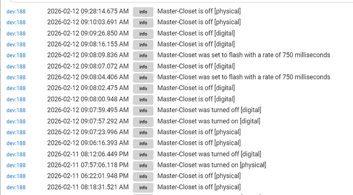

But for some reason Hubitat doesnt get the "on" event from Lutron. But it almost always gets the "off" events.
Any ideas?

As you can see it keeps getting the "off" events properly....but there is an "on" in between each one of those that HE is not seeing. There is one "ON" near the bottom but all the other ones are missing. (so the rule never fires)
Your logs suggest that @ogiewon's explanation might be on the mark.
You can test this in a few different ways:
  1. Move the Lutron bridge close to the device and see if the rule triggers as expected.
  2. Remove the dimmer from the wall, and move it close to the Lutron bridge (perhaps powering the dimmer using an extension cord).
If on events are recognized reproducibly, then it might be time to get a Lutron repeater.
