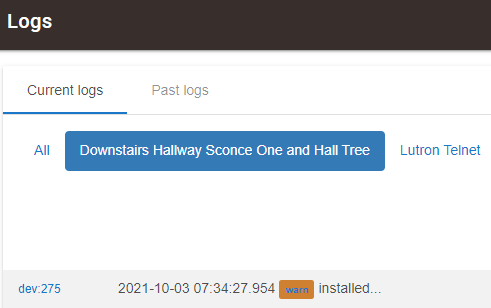

Did as you suggested. No Joy. The logs show the device installed and updates very quickly to show changes that I make through the Lutron app:
Showing changes by Lutron
Showing Installed

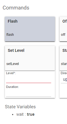

But on the device tab there shows no "current states" and it is in status "wait":
It is Lutron Device 46.
OK, I figured it out. It was my error. I had two devices listed as the same Lutron Caseta device ID:
d,46,Downstairs Hallway Sconce One and Hall Tree
s,46,Stairwell Closet
For others experiencing these symptoms, check that you didn't do something similar.
I had my devices in the Lutron Integrator sorted by room. I have now changed to sort by device number, and I would suggest that this is best practice.
