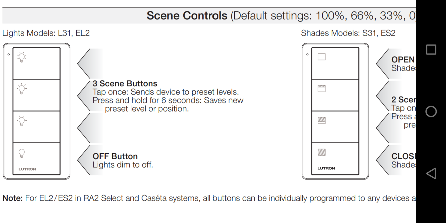

I wonder if the picos have the capability, but Lutron chose not to enable it for the usual style we buy. It is capable in the 4 button L31:
Press and hold for 6 seconds and you can set your level.
Perhaps, but 6 seconds is well beyond a users tolerance for a hold event, hold events should fire anywhere from 250 to 500ms after the device is pushed.
6 seconds is fine for a programming event, which is what this is. If that event is sent, we don't capture it, but I suspect it isn't sent over the bridge api.
I was thinking it meant this: Press the top button and adjust until you get your desired light level, let's say 90% brightness. Then press and hold the top button for 6 seconds, which stores that as a preset. The next time you press the top button, it will go to 90%, not 100%. You don't have to press and hold again.
Edit: Though I guess there is no way to get 90%, it's only what is available on that Pico, so never mind. :slight_smile:
I think you can set it to whatever level you want this way. In the 5 button dimmers there was a similar feature for the middle button, to set it as a favorite button. Didn't know you could do presets on the top 3 buttons of a 4 button dimmer.
