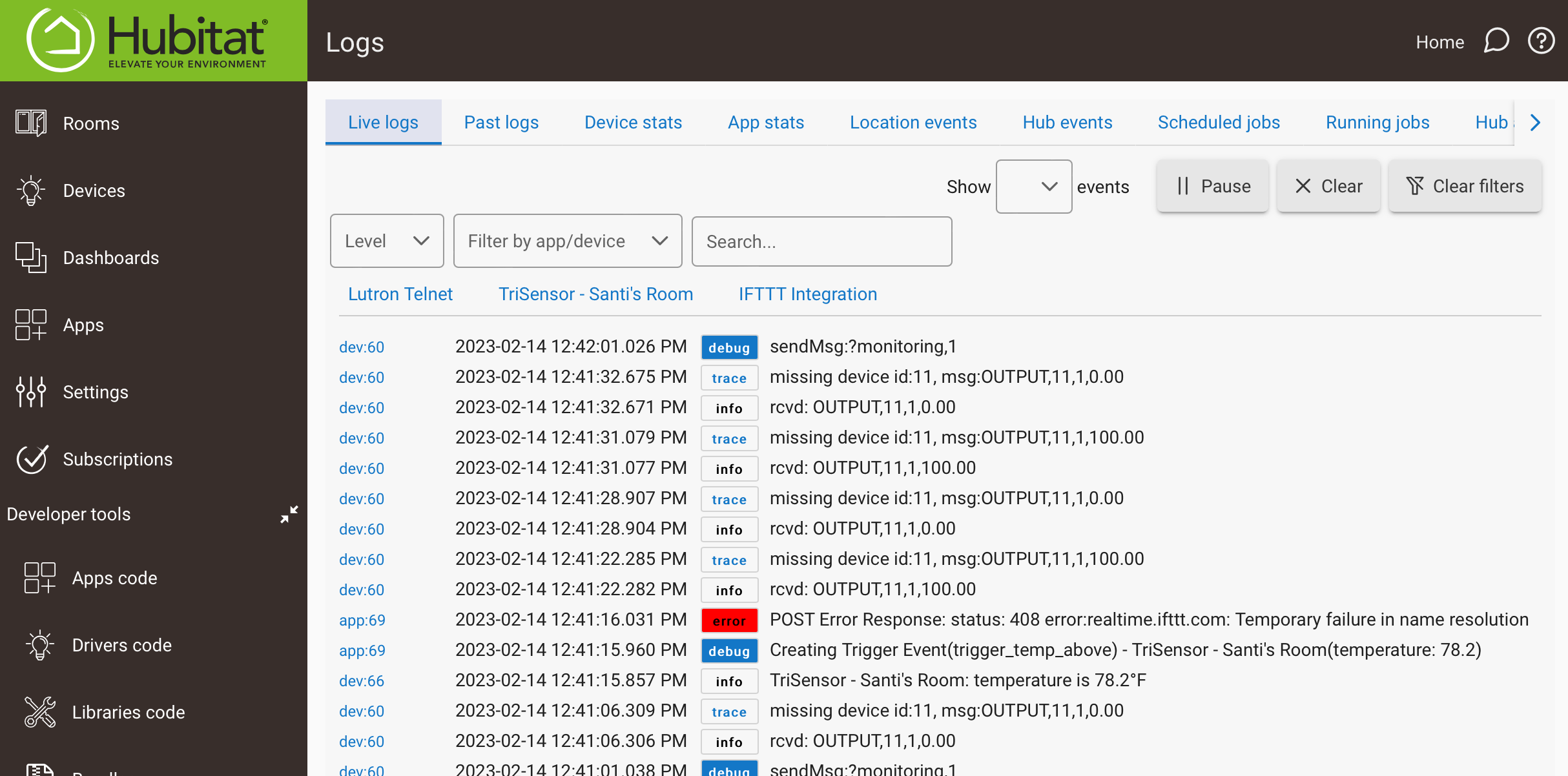

Can you enable debug logging in the lutron telnet driver, then turn the switch on and off, either physically or via the lutron app then post a screen shot of the live logs?
Messages are:
INFO rcvd OUTPUT,11,1,0.00
TRACE missing device id: 11, msg:OUTPUT,11,1,0.00
Here's the screenshot @mike.maxwell now that my trust level has been elevated on these forums. Thanks again.
right, if device id 11 is the claro, then it's not been included in the integration, which is what the log is saying "missing device id: 11".
can you post a screen shot of the integration settings?
Strangely enough, to answer your question, I went to the native Lutron app and examined the Lutron Integration Report and device 11 was named "Kitchen Chandelier". I renamed the device 11 in the Hubitat from "Kitchen Table" to "Kitchen chandelier" (note the case of "chandelier" is still not identical) .... and suddenly all was cured and 3 Claro switches in the kitchen showed up in the Hubitat device list all at once. They are all now operable through Hubitat. Bizarre. Seems like a bug (?) as I can think of no reason for that to have worked. Appreciated your help.
the names don't matter as far as the integration goes, the integration uses the id's, in this case 11.
The only reason I can think of that this would happen is if "done" had not been selected after adding the devices in the integration app.
